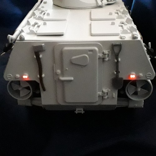

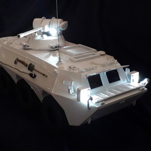

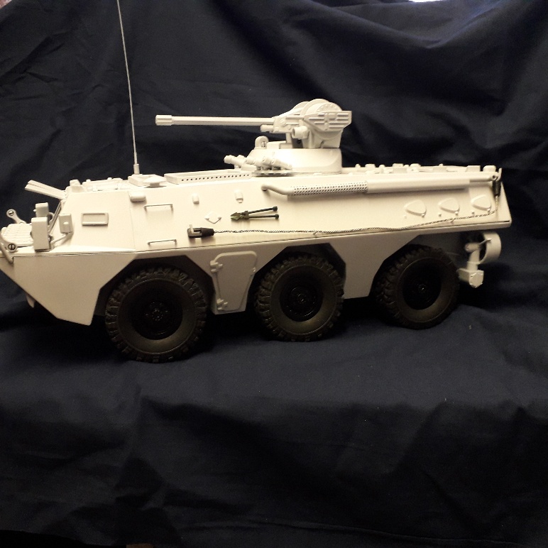

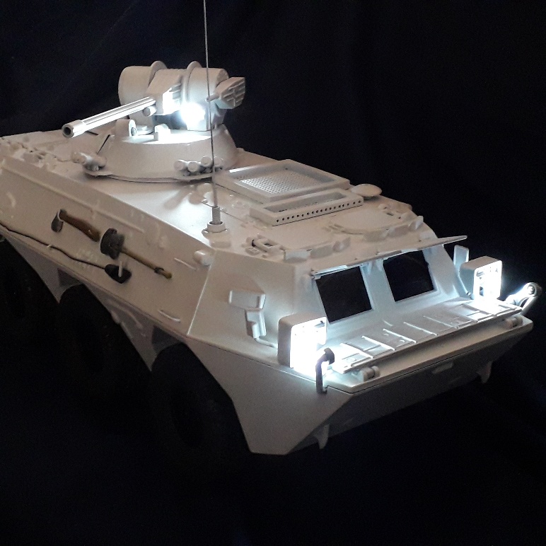

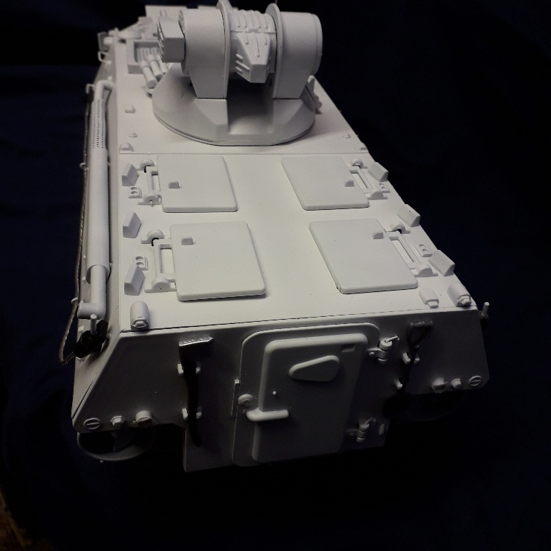

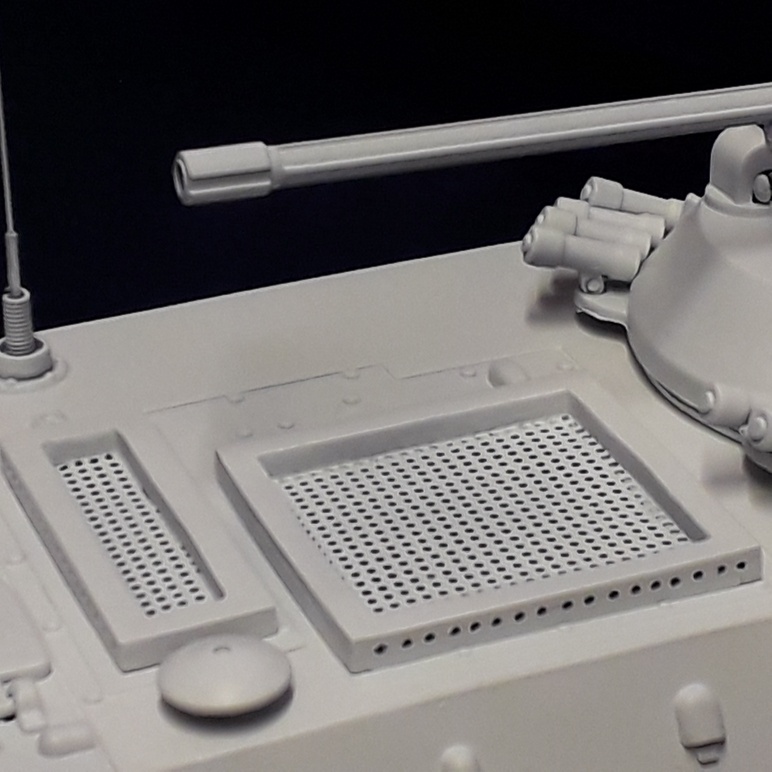

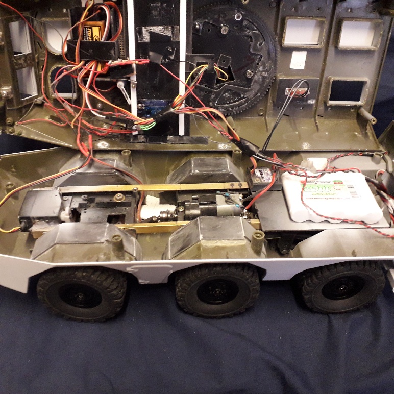

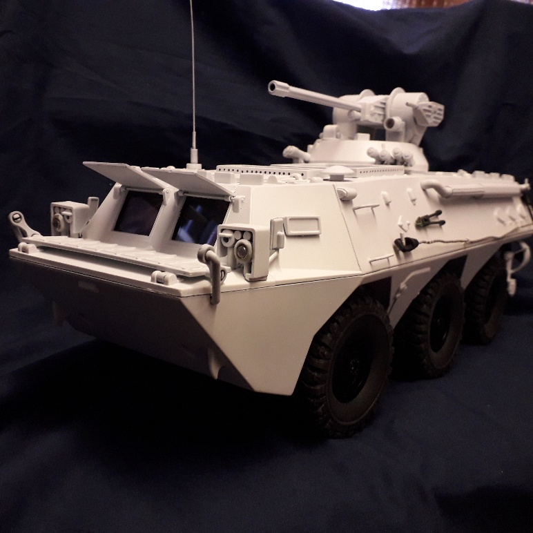

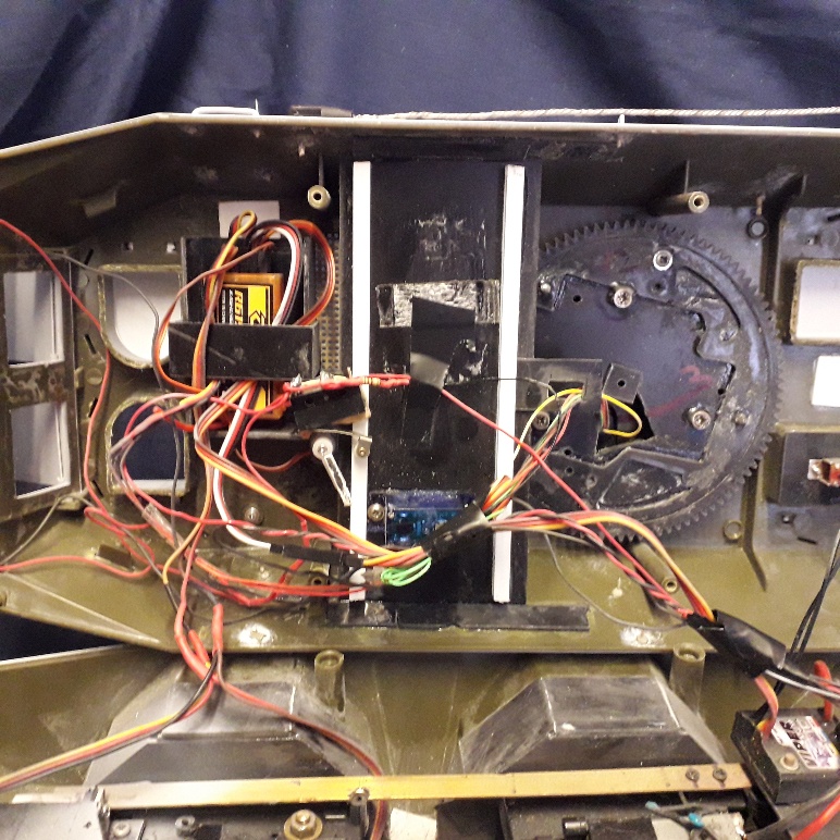

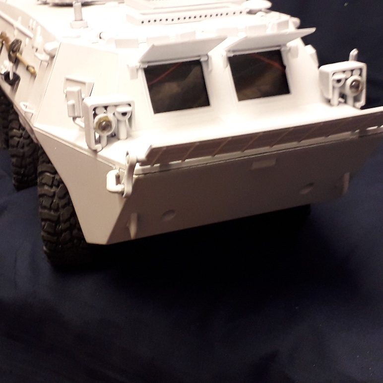

Hi Chaps.
Here is something i knocked together a few mths ago.
It has twin axle four wheel steer, is 4 wheel drive ( couldnt fit the central drive in with steering...no space )
A 360° 25mm turret with coaxial 7.62mm mc gun, full elevation and depression,, working gun searchlight all working through an 8 wire slip ring.
Working lights front and rear.
2.4ghz 7 ch radio.
Brass scratch made chassis
Using WPL modified axles, and re designed rear axle suspension.
Home made spun wire towing cables.
Just needs sound and a few markings.
Painted as a UN peace keeper.
Hope its of some interest.
Sub.

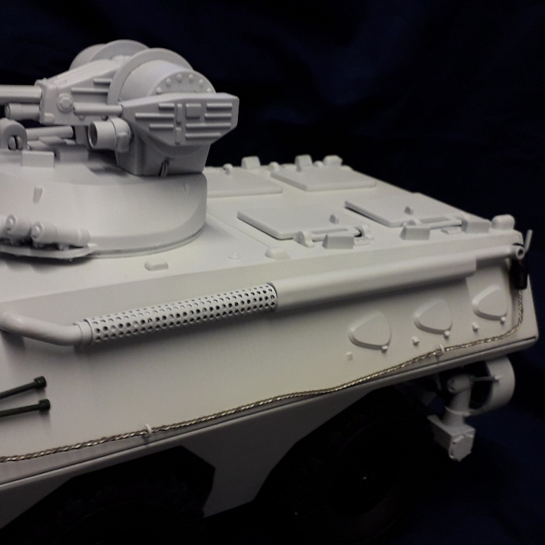

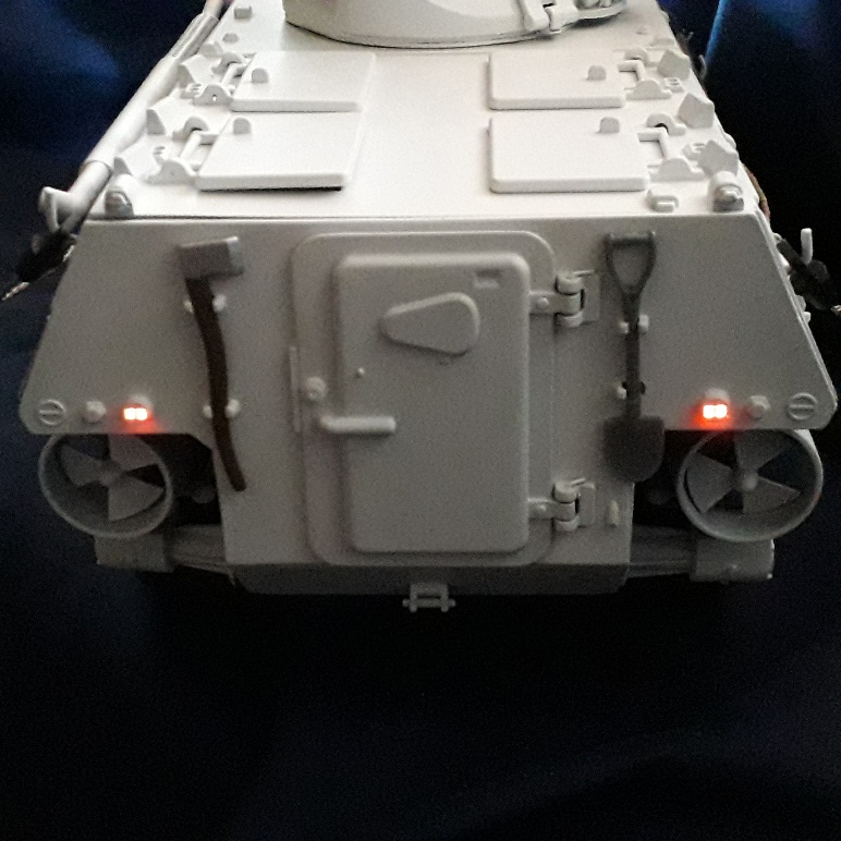

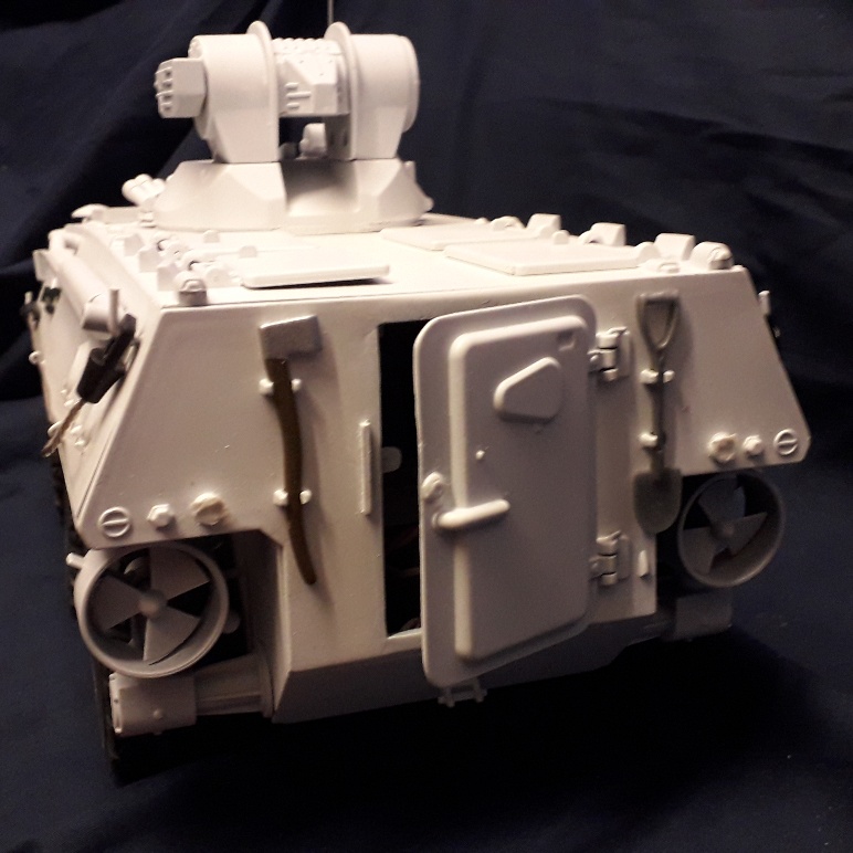

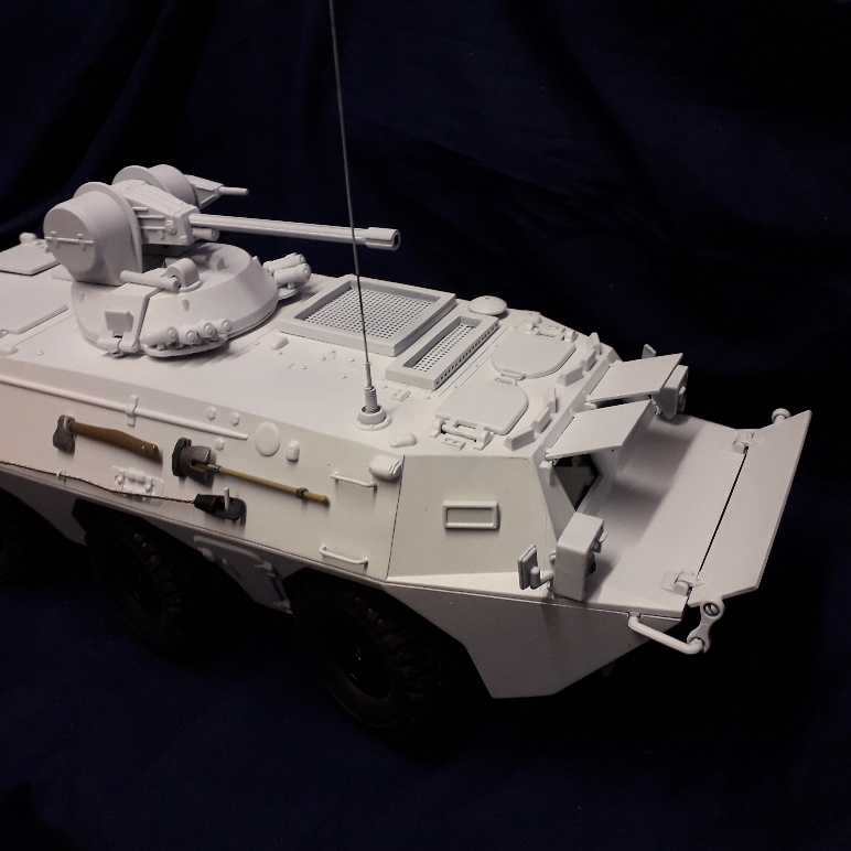

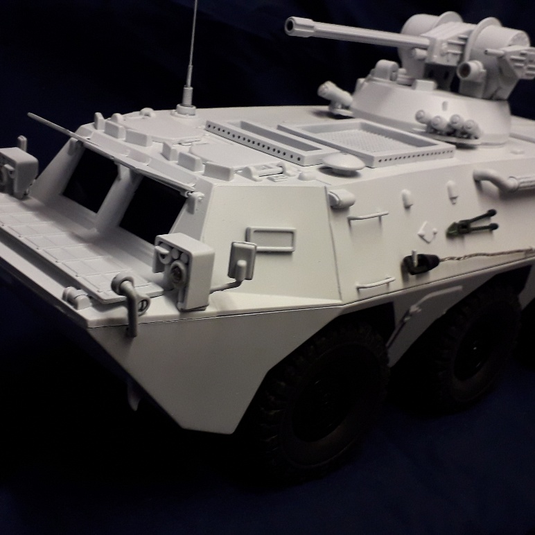

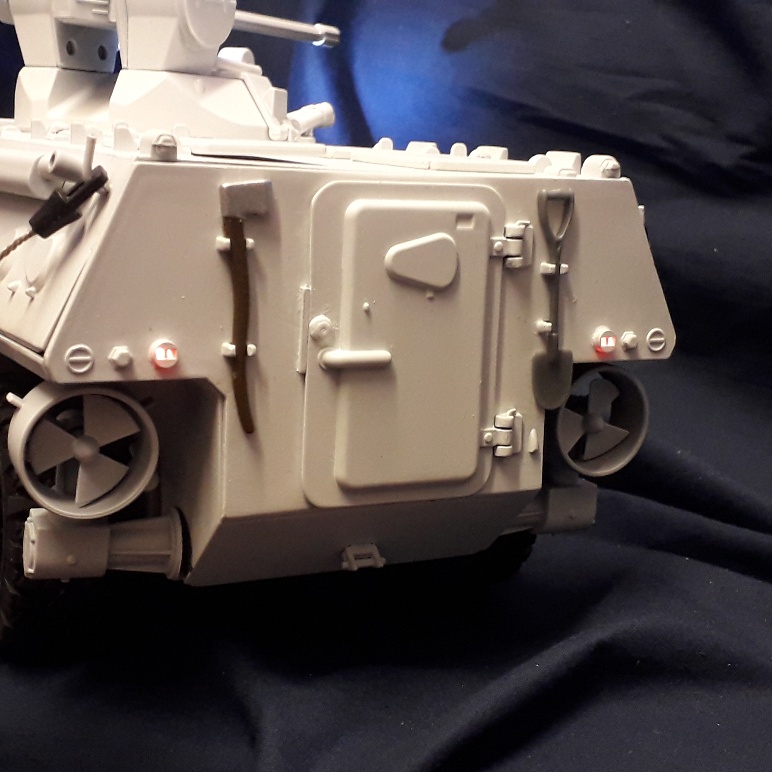

A few more.
Re: Norinco WZ-551 Infantry Fighting Vehicle
:clap: You should be very proud of yourself :thumbup: With camo and decals it will be of Museum quality. :)

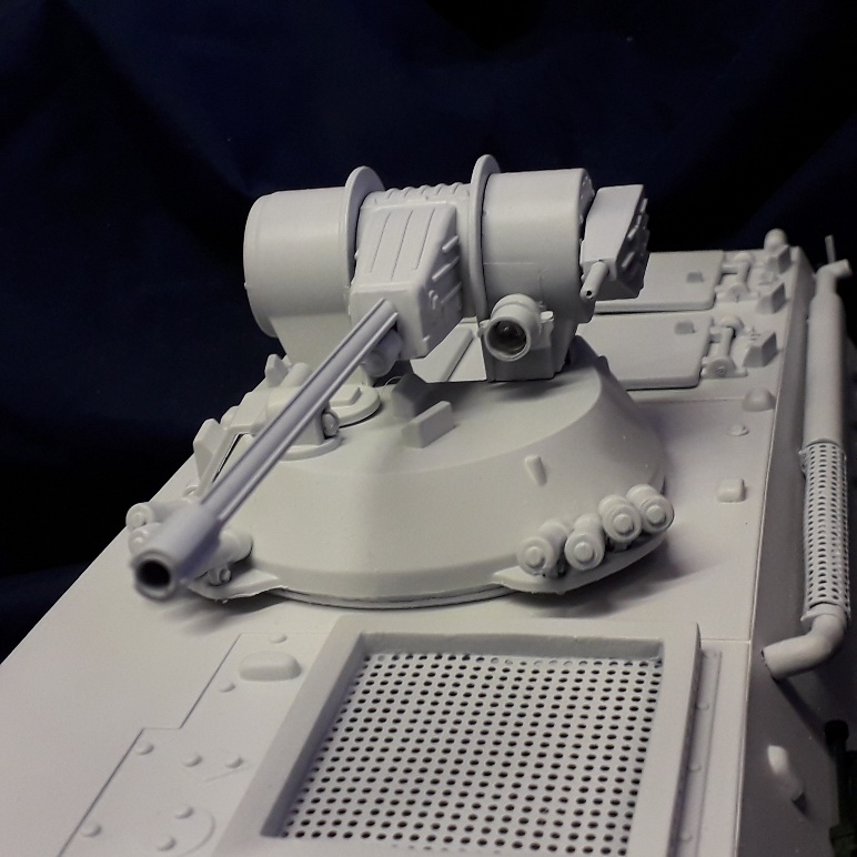

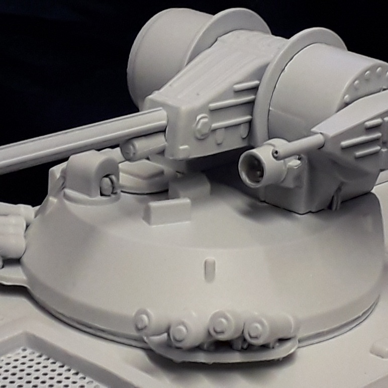

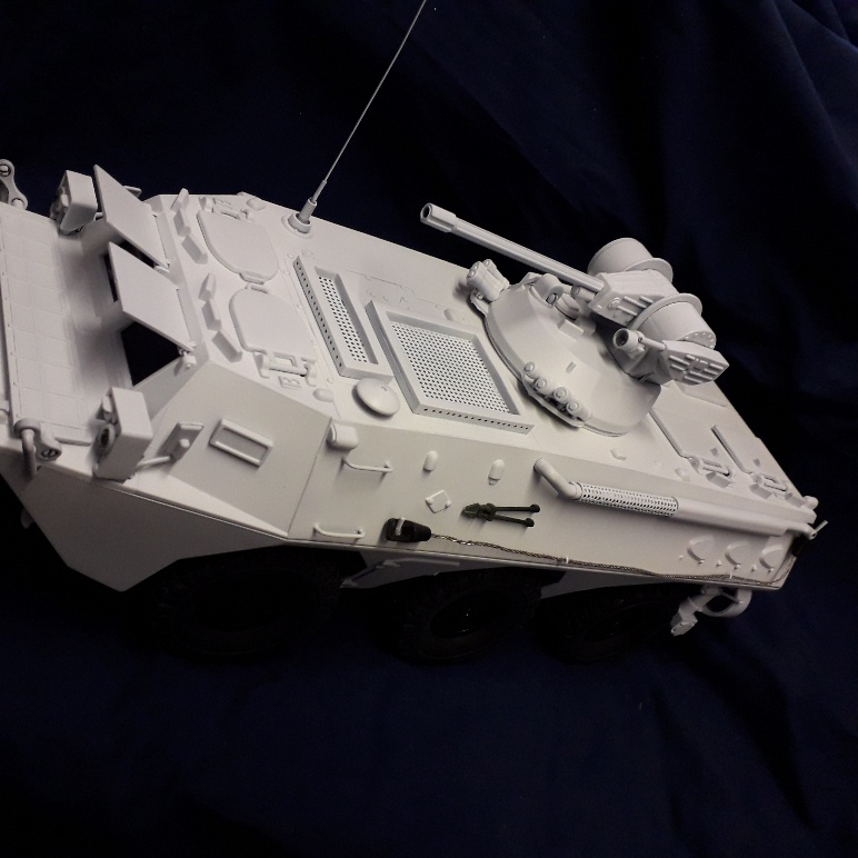

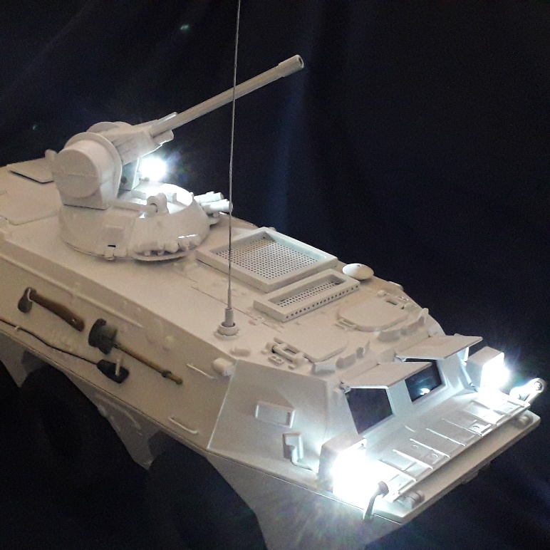

Hi.
Glad you liked it, it was an intetesting excercise to do.
One more pic showing 25mm elevated.
Sub.

Quality job,
Very nice, something I have not seen before.
You could also install a tank control board, like a Clark TK40 on this vehicle, which has 2 mg and would allow the main automatic cannon and coax mg to both have independent flash and sound. I also found that compared to an ESC, the TK40 offers good low speed power and control.
Congrats
