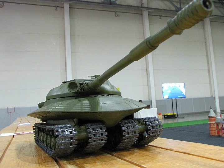

At the moment, all work on the project has been completed.
Work on this model began in late 2016. On the forum of my club, the process of creating a model was described. Therefore, in this topic, I will just post a translation from the club's forum.

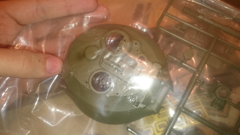

01.12.2016, 18:34
So, the model came in 1/35 scale from China.
The box arrived a couple of days ago. I didn't write, because I was thinking about whether the project is being implemented or not...
The result of thinking - the tank be!
I've already drawn the rinks and the leading star.
PS not all of the models correctly. Trust but check... I check with photos of the real car, which are not so many.

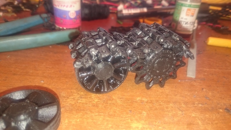

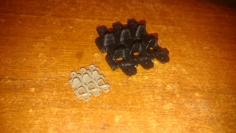

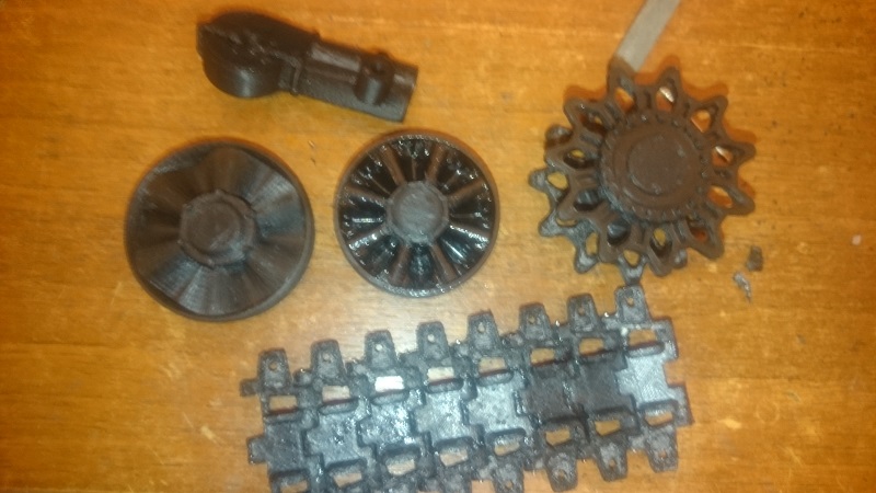

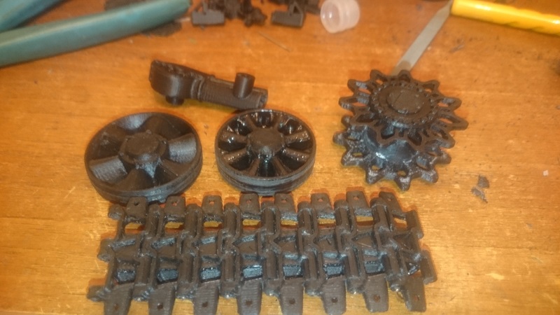

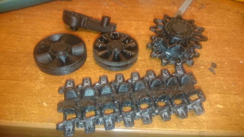

The tracks are worked out and ready for the series.
The rollers are made for two bearings with a diameter of 10 mm on a shaft of 5 mm. The leading sprocket will most likely have a different internal diameter, but the crown will be the same.
Suspension balancer for standard spring HL (the number of turns may be different).
