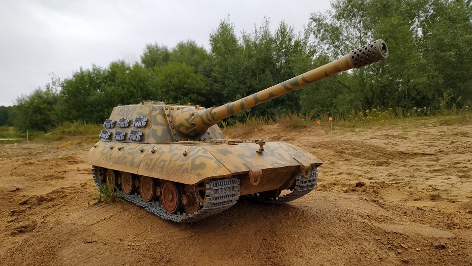

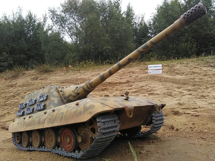

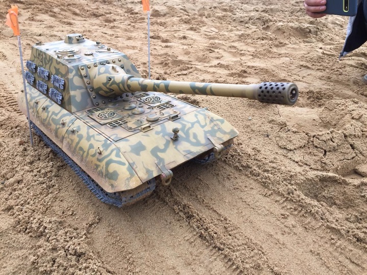

I want to show everyone my project of a super-heavy self-propelled vehicle based on the E100.
The project was completed about a year ago.
This is completely my development.
Of interest is the two-speed gearbox on each engine. Drive to both gearbox from a single servo.
Each suspension element is individually adjustable (including the guide wheel).
If you are interested, I will look for more photos of the creation process.

That's an exceptional beast!

Amazing! Is it all printed?

Not fully created on a 3D printer. Massive flat body parts are laser cut plastic.

Nice job

Very good :clap:

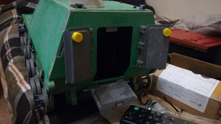

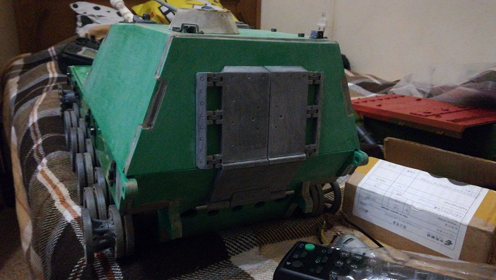

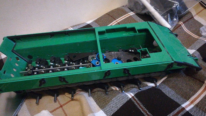

Initially, the creation of this model was not included in my plans. However, a familiar guy ordered a model of the E100 tank.
The budget was extremely modest. So, with his consent, I decided to make myself another model (a clone model).
During the build process, I decided to change my plans a little and build the Jagdpanzer E100.

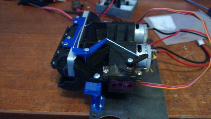

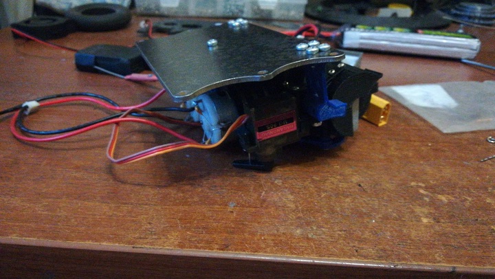

Two-speed gearbox of the tank model.

Very cool. I always did love those paper panzers. I can't wait to see video of that 2-speed gearbox in action. That really interests me. If I live long enough I might try to build one of these Someday, but I think I would start with the JagdTiger Lower Hull to make it just that tiny bit longer.
I really like the doors on the rear, what are those from?

Max-U52 wrote:Very cool. I always did love those paper panzers. I can't wait to see video of that 2-speed gearbox in action. That really interests me. If I live long enough I might try to build one of these Someday, but I think I would start with the JagdTiger Lower Hull to make it just that tiny bit longer.
The tube is modeled after the game "World of Tanks". This is probably the most likely version of the model.
As for the transmission, I can say that this is an outdated design. Now I install a completely different gearbox on the model, which has 5 speeds. But I will write about this in the next posts.
