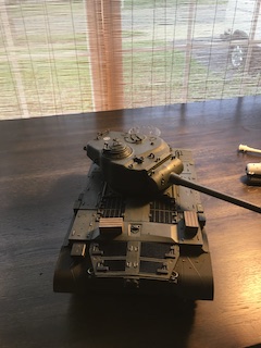

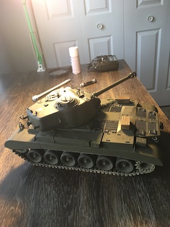

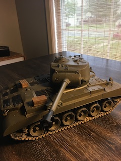

Hello everyone, I finally started a thread for my Pershing. As it stands right now, it's just the basic Heng Long plastic version. I do have some more goodies here andon the way, though.. :D
-Custom stencils from Rad
- JCC Compact recoil
- Mako 2020 Board
- Tamiya barrel and mantlet.
Here are some pictures of it, I apologize for the crap lighting, it's just a lamp...
I'm am having a small problem though. The Tamiya mantlet doesn't fit over the HL under mantlet (The piece the mantlet moves on.) The Tamiya parts also don't fit into the HL turret. Does anyone have any suggestions? Or tryed something like this before?

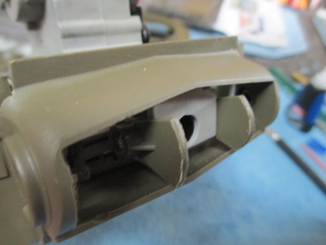

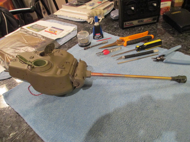

Good Morning,

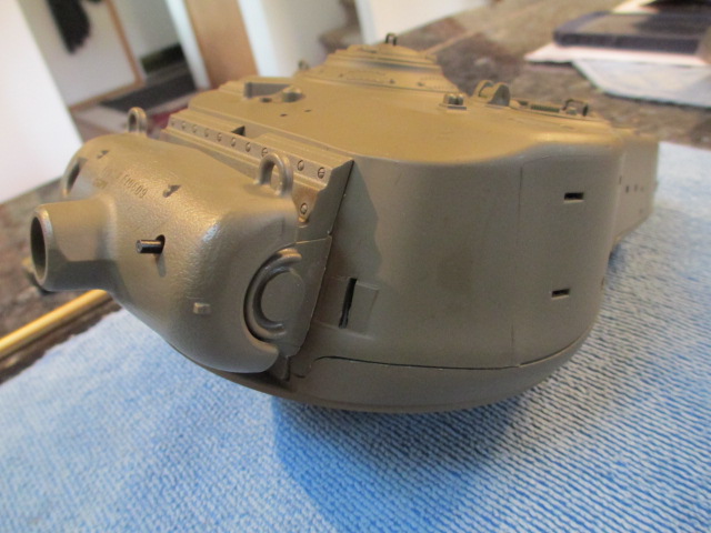

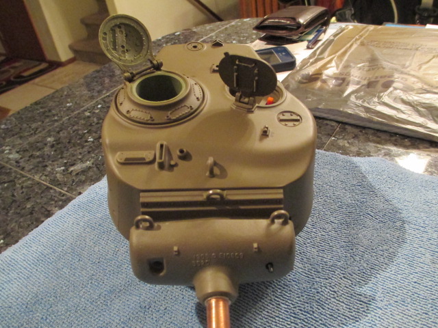

Looked through the Pershing Build that I posted some years ago and the method that I used is there. It has lasted and is still solid and looks the part. Use the proper epoxy and you will never have a days trouble with it. ( just don't let the dog drag your completed tank off of the display desk ;o)
A scratch trunnion and mantlet mount made from a Tamiya cable mount.  Cut it in half and rounded the edges to fit the mantlet interior curvature..JPG
A scratch trunnion and mantlet mount made from a Tamiya cable mount. Cut it in half and rounded the edges to fit the mantlet interior curvature..JPG (78.71 KiB) Viewed 5185 times

Hmm, well I was thinking of doing it differently. I was planning on cutting slots in the flange on the Tamiya under part, and slotting it in.
I don't know how to keep the manlet secured, and attached to the barrel. Ideas?
Posts: 7695
Re: HL Pershing Project
Good afternoon,
Brass pins secured by drilling and two part epoxy. The ears in the photo above were drilled and corresponding holed drilled in the mantlet. Two per ear. The barrel is a custom one off by Alpha. A brass airgun barrel that fits into the HL airgun and works. The whole thing works like the original HL airgun...just with correct trunnions and a Tamiya mantlet and one off barrel.

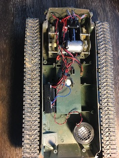

After a bit of a break, I'm back on my project. I have run into some more issues, though. I didn't realize that the HL elevation was run through the airsoft unit, so now I am waiting for another servo...
Another small problem is with the barrel diameter. It fits like a glove in the unit itself, but it is too large for the interior moving piece.
But everything has arrived now, and I have time to visit the hobby store, so hopefully I can start making some progress.
