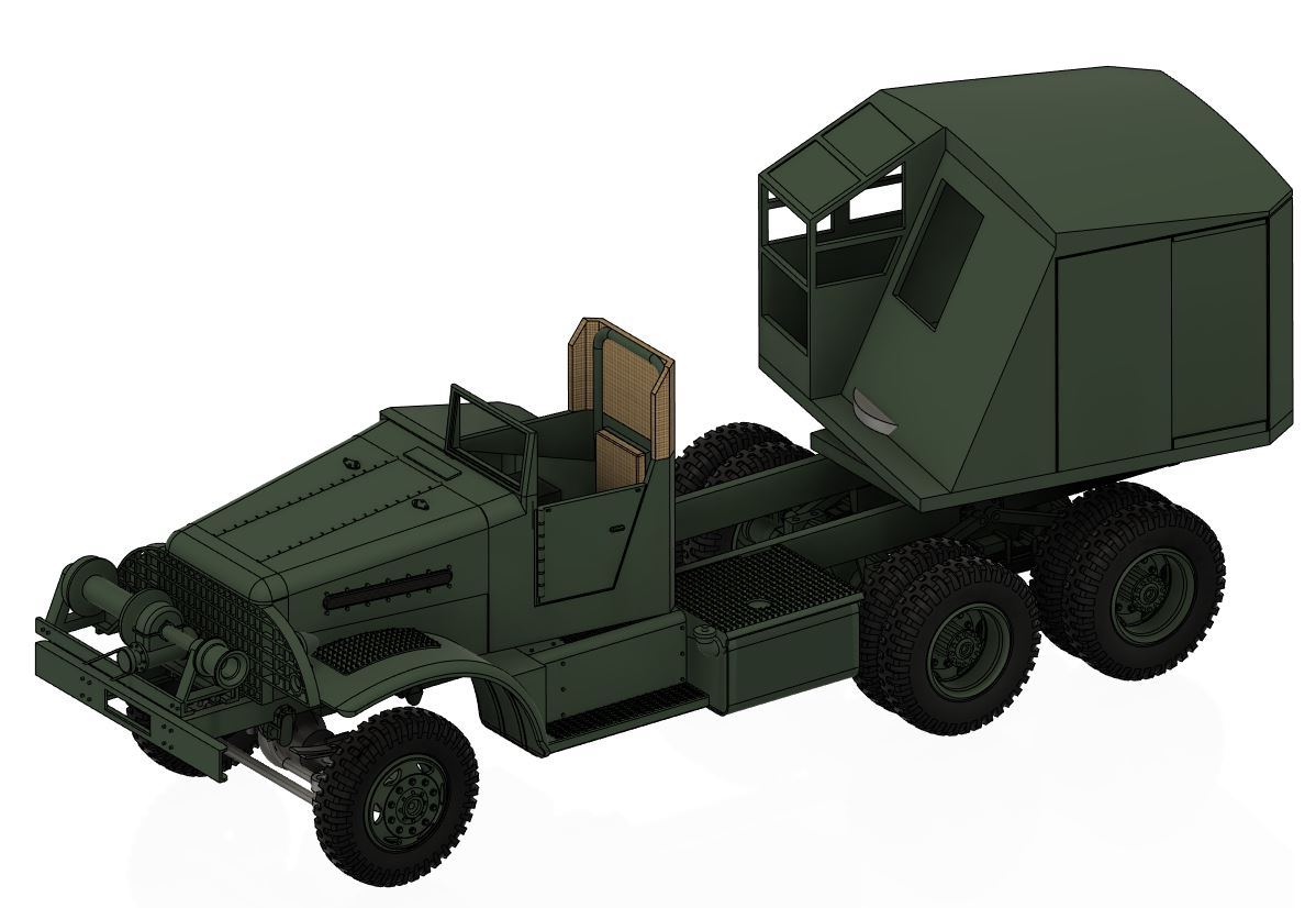

Had some time today to have a play with this:
Brockway C666_a.JPG (91.82 KiB) Viewed 1685 times
Re: Brockway C666 Crane
This is a really interesting piece :clap:
Brockway C666_b.JPG (97.37 KiB) Viewed 1638 times
Estnische
Posts: 1198
Post by Estnische »
Is that image from an STL file? If so, how do you remove the wheels to print it?

Estnische wrote:Is that image from an STL file? If so, how do you remove the wheels to print it?
In the CAD world its easy - what you are looking at is called an 'Assembly', made up of many discrete parts. The tyres are their own individual model that I can export and print independently from the rest of the assembly in either TPU or TPE filament.
All you need is a printer that can handle that material - in the case of TPU you need to think of pushing a wet noodle down a drinking straw - the closer and straighter path the better.
I recommend the Anet A8 for tyres because it has a direct drive from the feed motor right down into the extruder - little room for the filament to wriggle out :thumbup:
If you can get a super flexible PLA filament, then you can get similar results from a bowden drive printer like the Creality family, but my one known good supplier (Rigd.ink) exited the market a while back so we are stuck with what we have :( Currently in the UK I'm using Sainsmart TPU - Ninjaflex might be more readly available in the US and elsewhere :thumbup:
