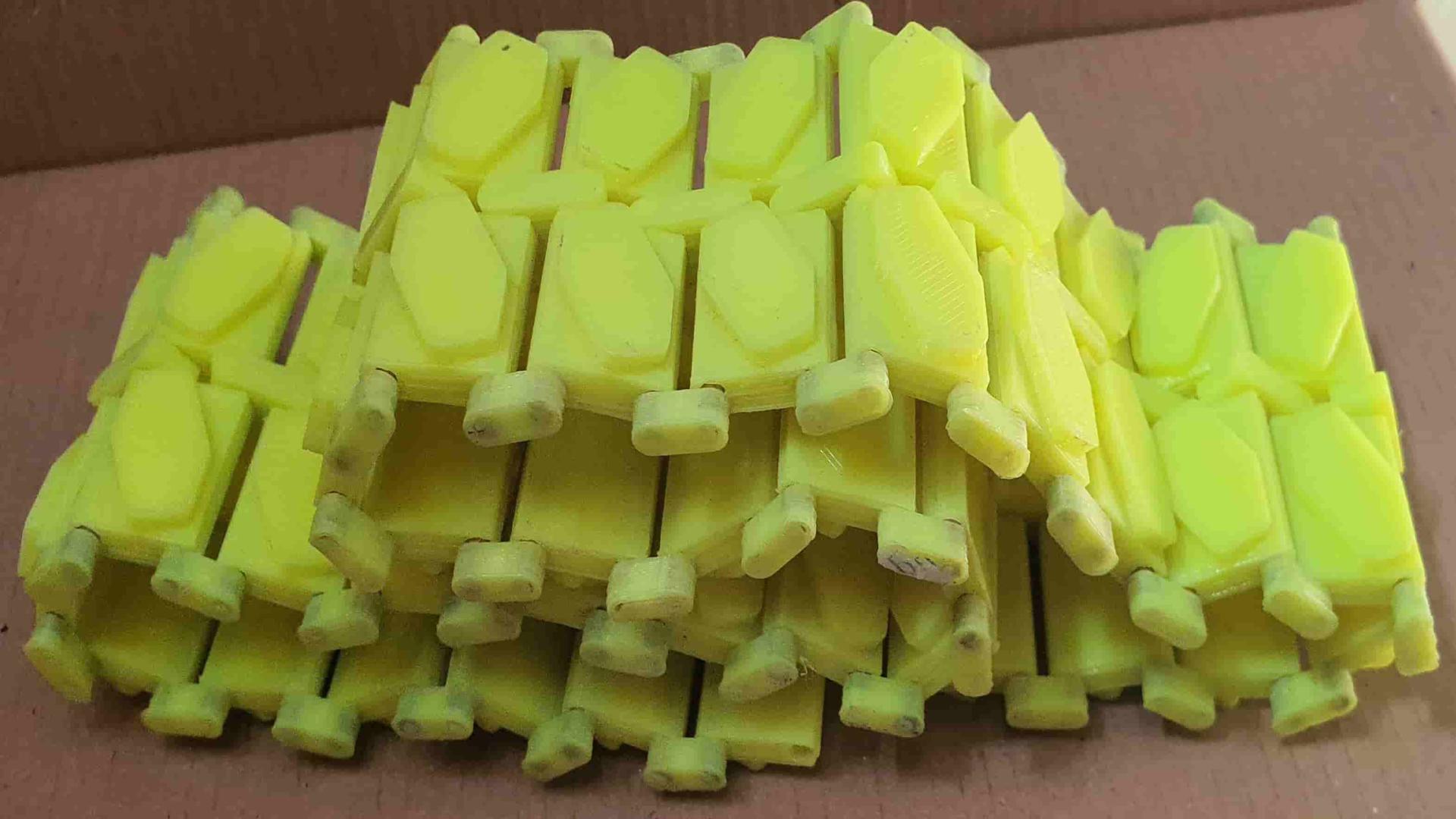

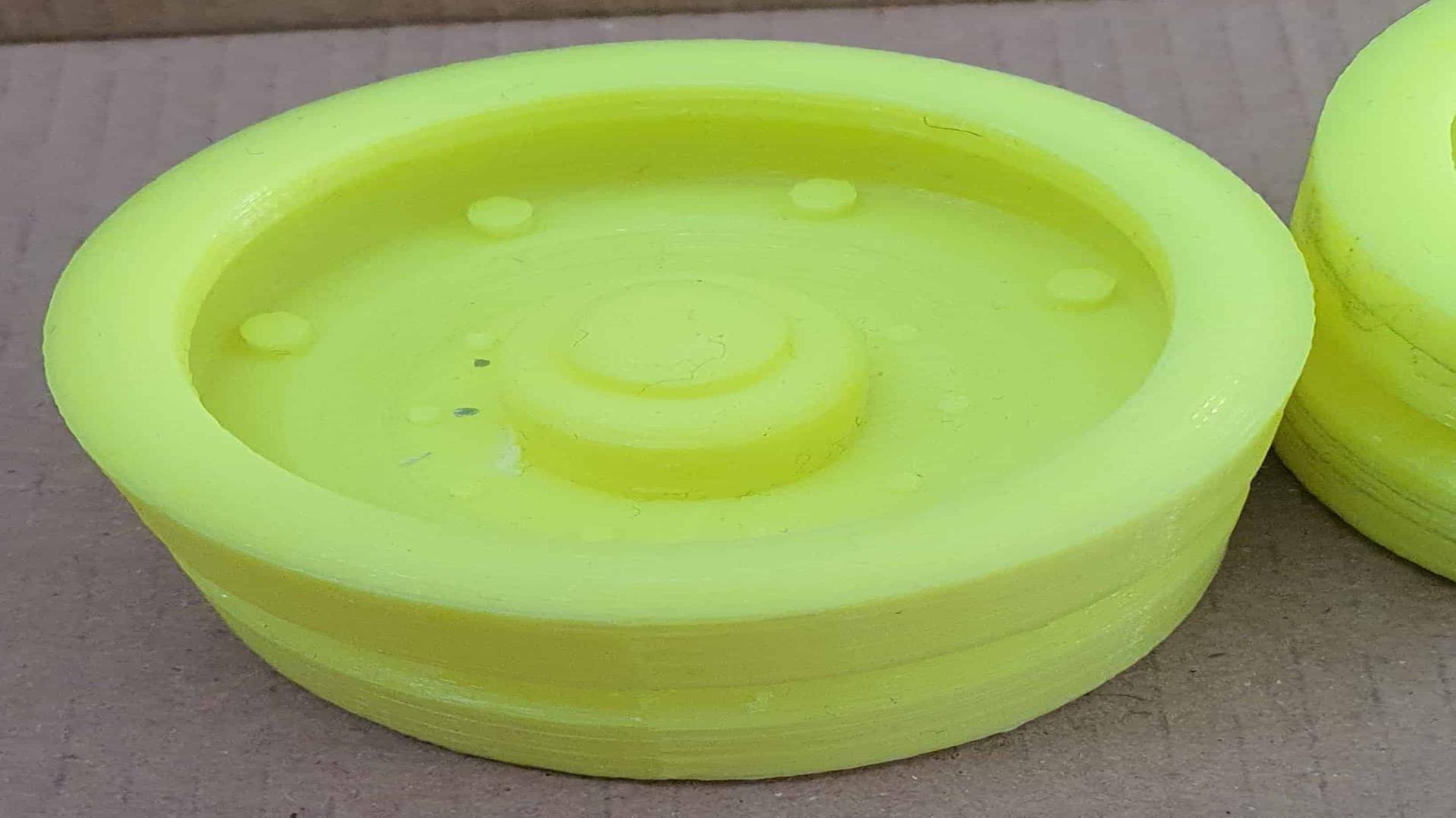

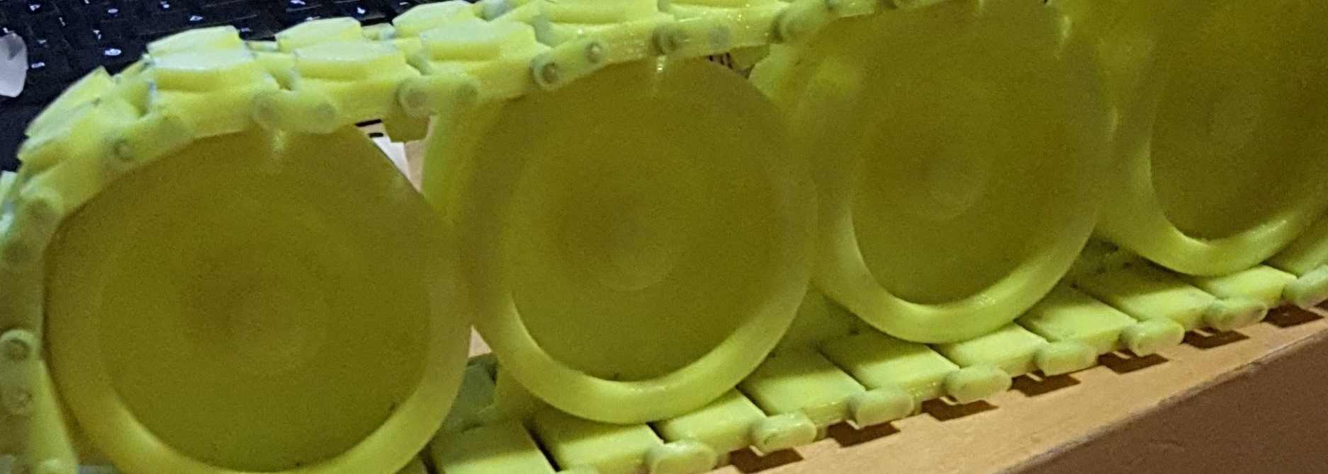

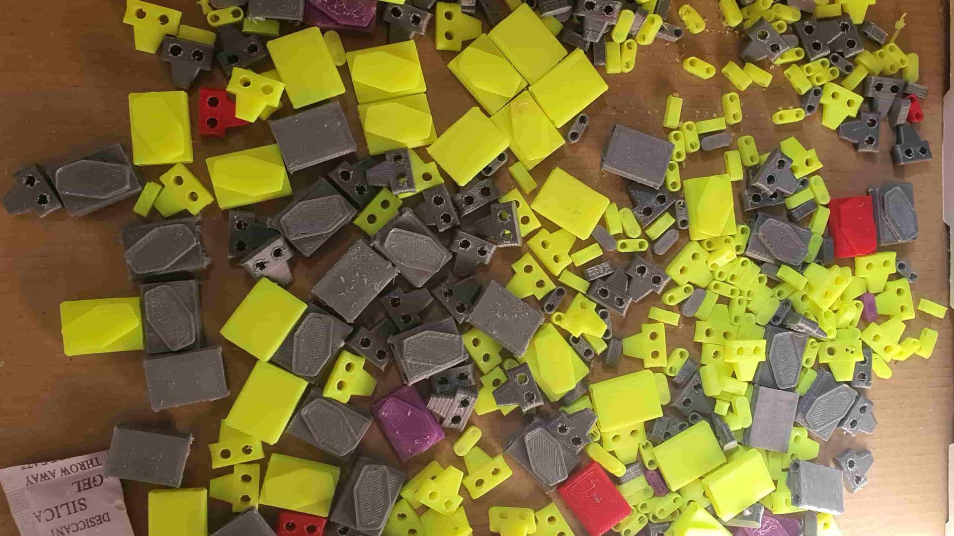

the progress so far: so the start of my build i decided to start with the tracks to fascillitate with measurements ive made an excel spreadsheet with various measurements st scale them to what i need based mostly with information from the internet ive constructed some track padsguides and endcaps
due to how small and tedious they are there are no bushings the have a 3 mm hole but the track pad holes are opened to 3.2 to allow smooth rotation im happy with the outcome so far
i have also done the sprocket and the roadwheels
to adress the reason for the 1/11 scale was because i started with the track section first i initially had 1:14 th scale the pin diameter was 2.4 i had a 2.5 mm drill which was ideal however i didnt have enough clearance to allow rotation and i wasnt aware of any 2.4mm rod or 2.8 mm drill. at 1:11 the pins scale down to approximatelt 3.17 mm the closest stainless or brass rod size i could get was 3mm and i had 3.2 mm drill for clerance on the track pads
i should also mention this tank is mainly 3d printed so far
