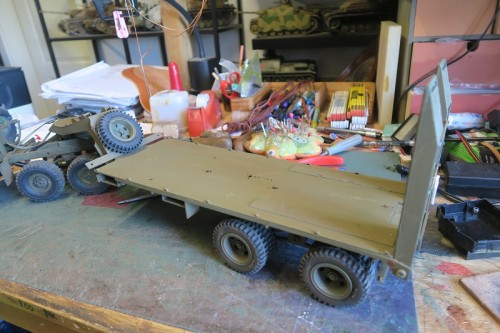

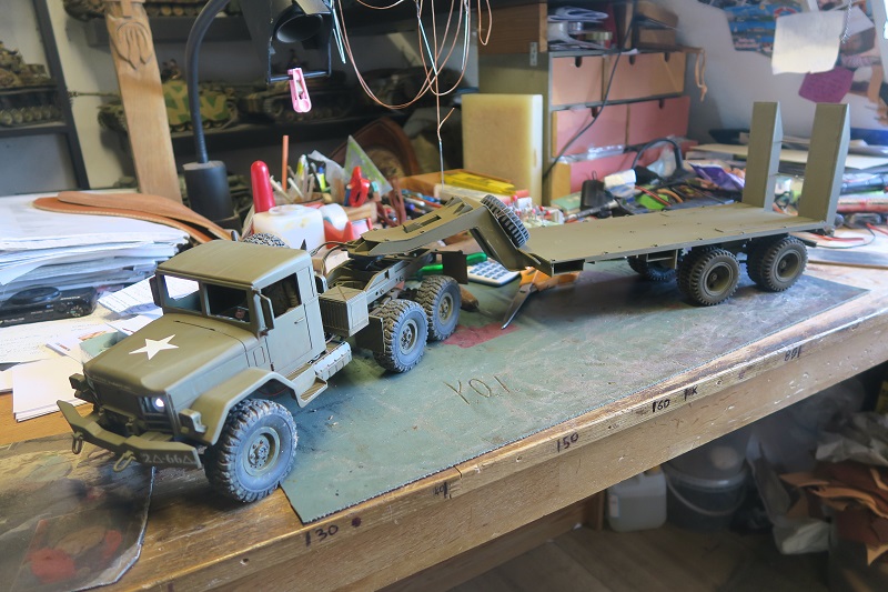

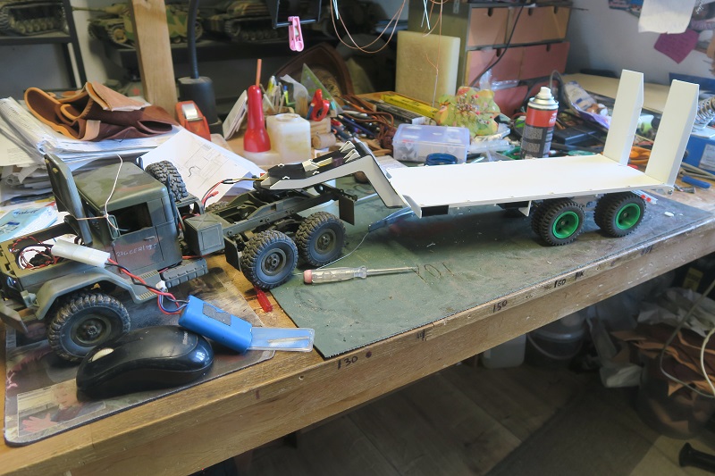

Some time ago a friend give me an M35 Reo with the saddelpack from Ludwig. It was already buil and drives well.
An other friend build me an trailer, also from Ludwig.
And i finish everything and bring it together.

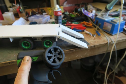

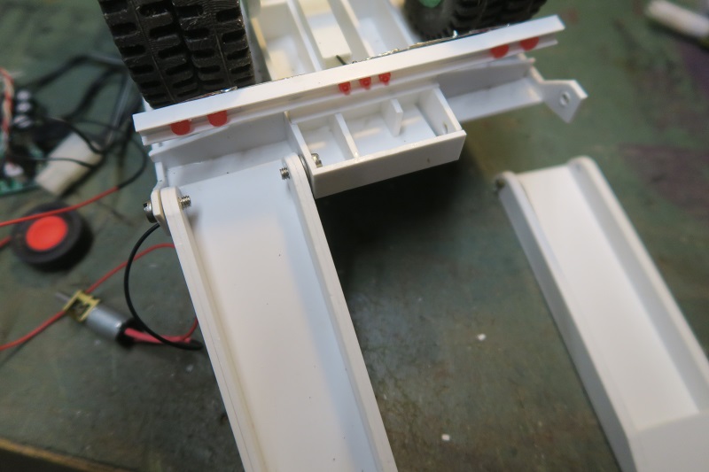

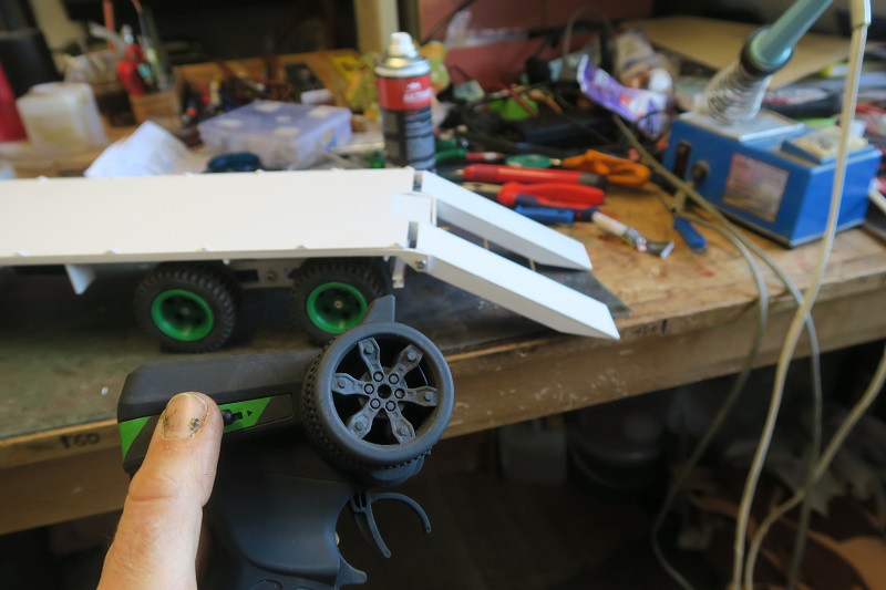

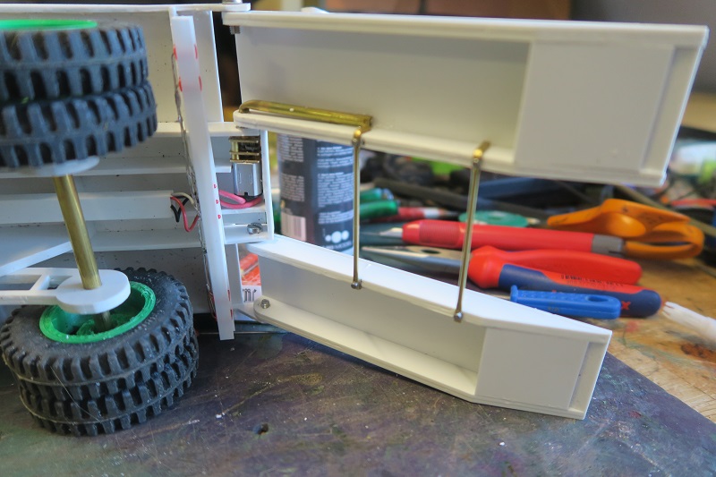

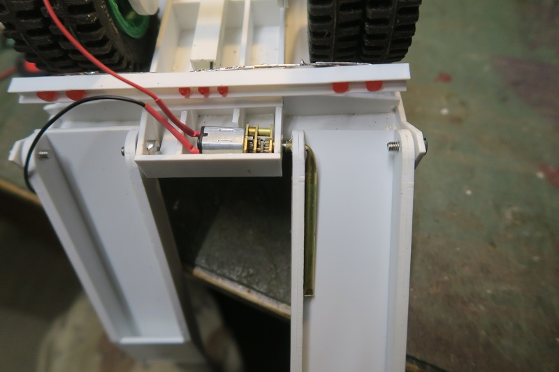

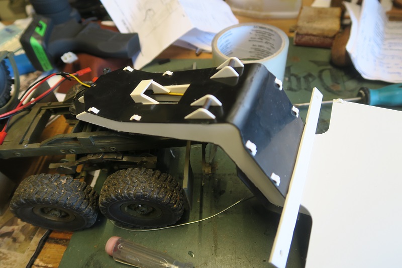

I want that the ramps (like on my Dragon) work, i made this happend with an smal N20 geraboxmotor, that work out all right and was the simplies.
I give the truck the new WPL soundplatine V2, there you can connect an winsh ore what ever, that port i used for the ramps.
Here are some pics:
give em some detais:
The ramp must be fixed together, cause only one is driven:
And by the way the old trailer get ne weehls:

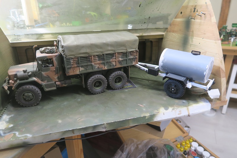

And Olaf also made my an watertrailer:

Here is a smal video of the funktion:
...it works a bitt fast...but better than nothing..... :thumbup:

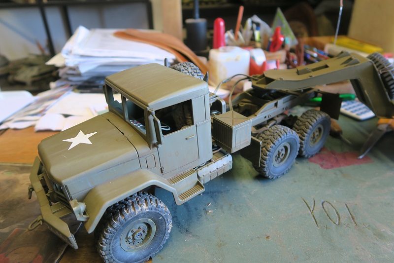

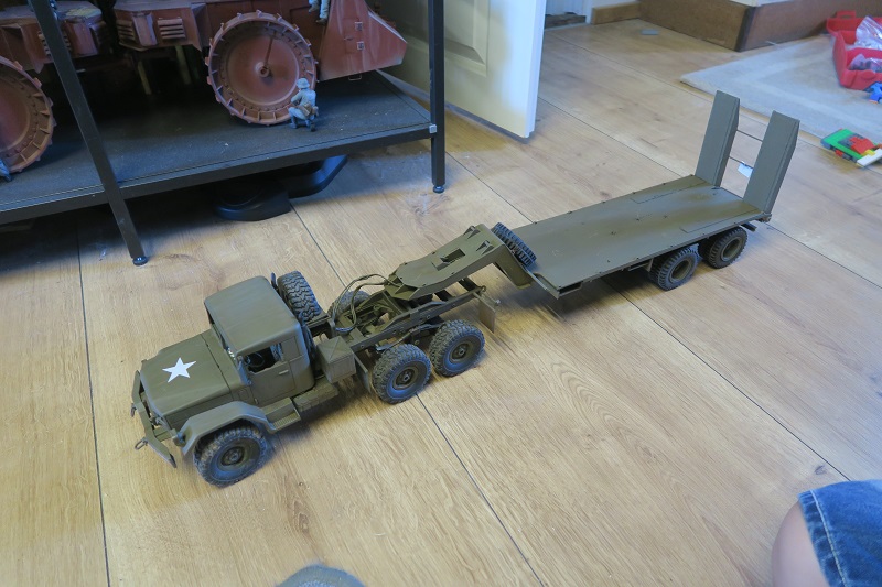

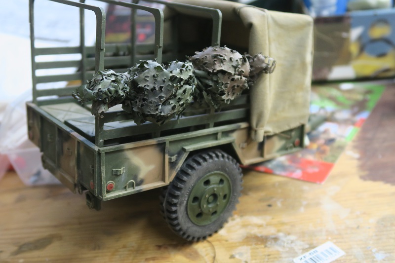

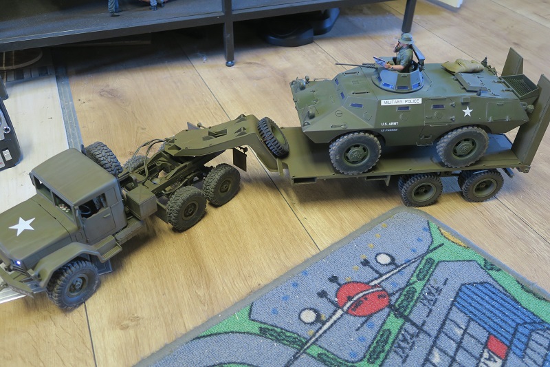

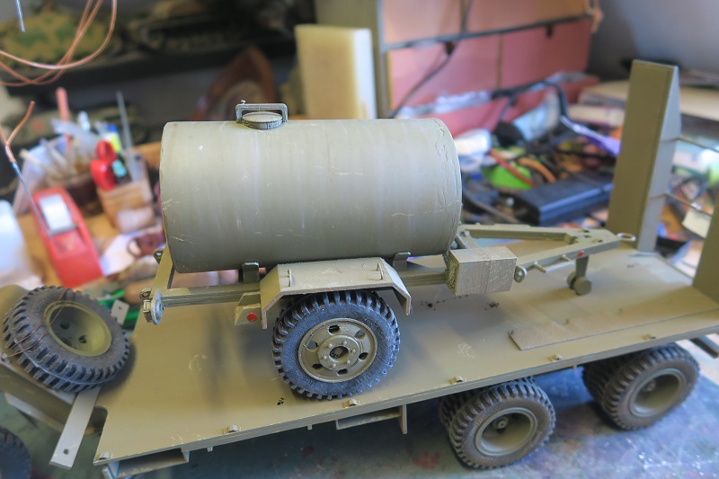

now with colour an a bit wethering:
And the Watertrailer:

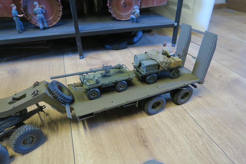

on the floor:
a bit to mutch:
that work out:

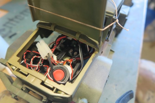

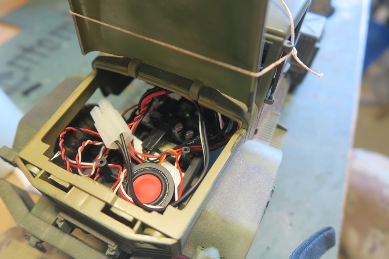

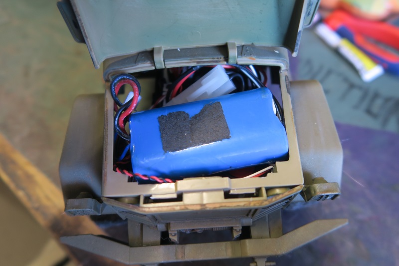

And accu, speaker and wpl platien inside the cab:
