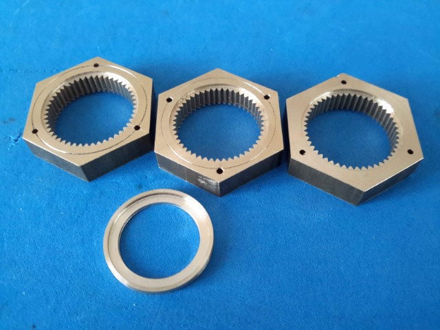

Re: Scratch building a planetary gear box
Post by walter »
Parted into individual housing sections.

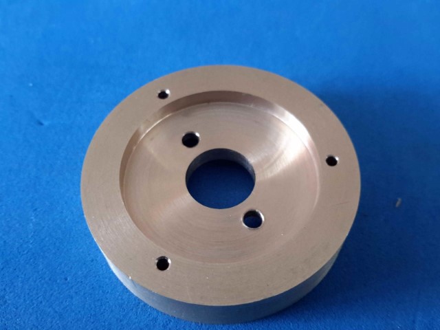

Post by walter »
Motor end housing.
IMG_20190928_095123 (2) (Small).jpg (71.55 KiB) Viewed 8442 times

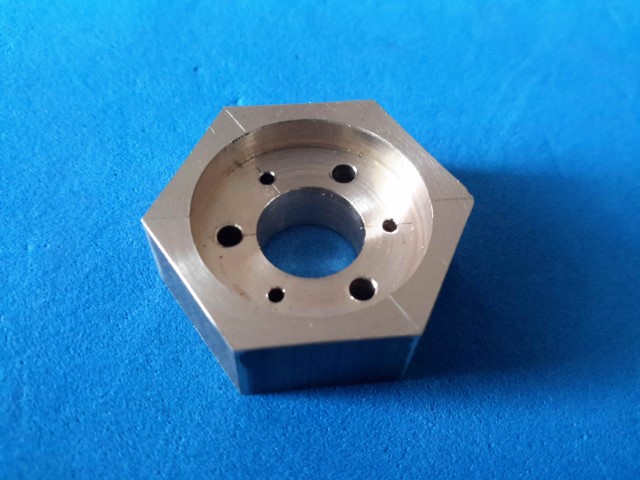

Post by walter »
Drive end housing.
IMG_20190928_095123 (2) (Small).jpg (71.55 KiB) Viewed 8441 times

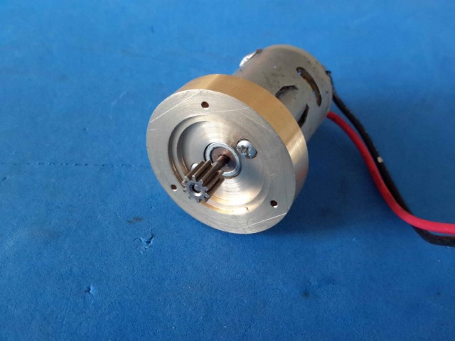

Post by walter »
Motor end with motor.
IMG_20190928_094938 (2) (Small).jpg (80.79 KiB) Viewed 8440 times
