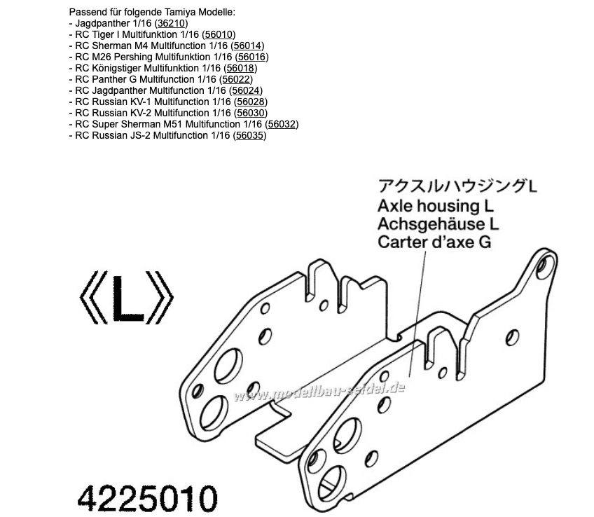

So far as I'm able to tell, most Tamiya gearboxes are pretty much identical. They all use the same gears, I think, but differ only in the type (and size) of output/drive shaft used.
If your output shafts are OK, you could try taking the gears from any other available Tamiya units, and fitting them to yours. The gear cases are all identical:
Tamiya Gearbox housing
