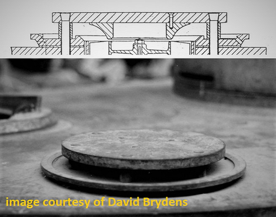

That photo is not a picture of the "vent", is a picture of the factory fitted Deep Water Wading cap or "Tiefwasser-Wadenkappe" which was clamped over the Turret vent to seal off any water ingress should you decide to take your early Tiger 1 and dunk it into a River over 10.0ft deep !. They all rolled out of the Henschel factory with one fitted until the Autumn of 1943 when the idea of deep water wading was largely abandoned. The actual vent looked like this :- Aside from the 1/6th scale versions I have never seen the cap in 1/16th scale on the market But with a little bit of thought and the fact that I have a lot of 3D printed 1/16th "wing nuts" in my garage I think I could scratch build one for you...call it "Corona therapy" or as that lovely man the late Roger Ridley from Santa Monica CA of "Playing for Change Fame" once said, " I do it because I'm in the joy business "... Let me know Buddy Mi Casa su Casa. One Tiger tank fan to another.

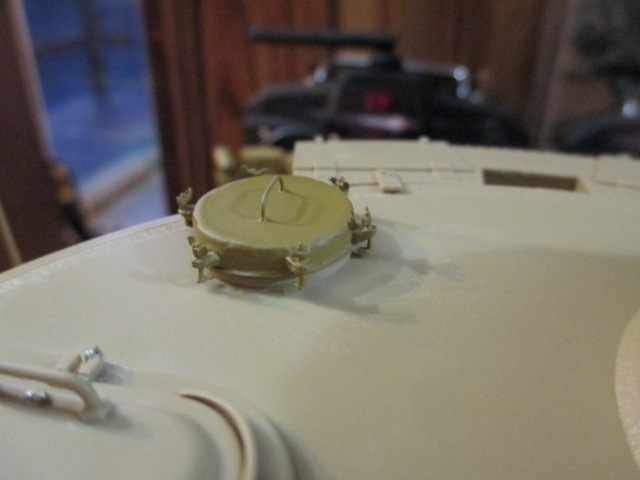

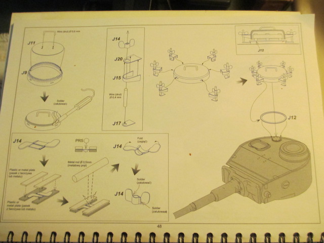

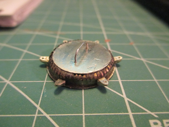

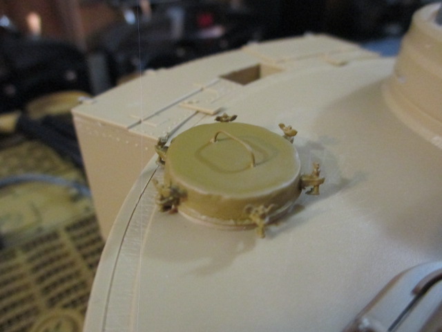

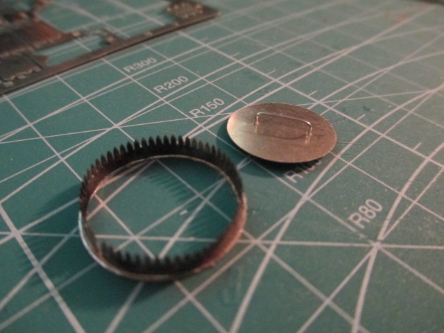

If needed still, ABER has it as part of their Tiger brass set for 1/16. I built one and put it on Mike's Early Tiger. It is a skill tester for sure.
- The ABER turret vent armored cover in paint.JPG (76.49 KiB) Viewed 1539 times
- Adding the solder ring and a little putty really smoothed it out. I'll be using magnets (if possible) to attach this so Mike can remove it to show the actual vent underneath..JPG (79.41 KiB) Viewed 1539 times
- Almost there.JPG (82.16 KiB) Viewed 1539 times
- A little further along.JPG (90.52 KiB) Viewed 1539 times
- ABER instructions.JPG (95.22 KiB) Viewed 1539 times
