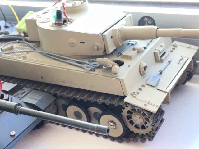

I have owned this grey Tiger a long time, 34 years and have used it as a test bed for experimental electronic speed control experiments and somewhere along the line lost the original box and parts needed to complete the outer body.
Grey Tiger Specs.
the original 1.4 ohm motors have been switched out to 4 ohm.
motors are in single source current, parallel drive configuration.
2.4 ghz simple function 2 channel radio gear from ebay donor model.
custom ESC with pulse proportional throttle.
L\R turning opposite track speed is tunable

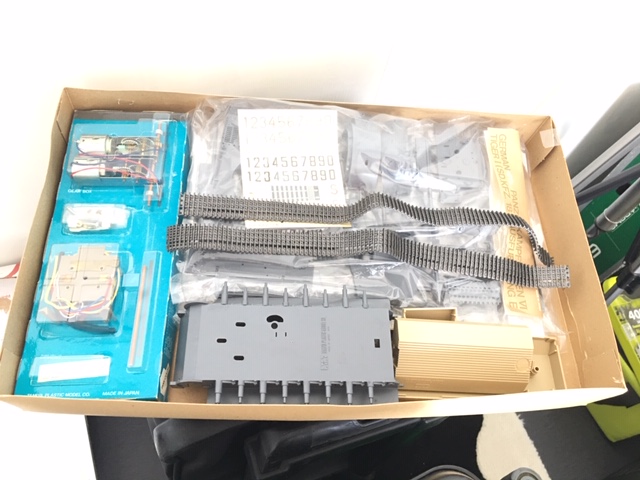

NIB dual motor remote control Tiger.
Got this one from ebay for parts but fixed it up instead. Added Tamiya individual link tracks..
