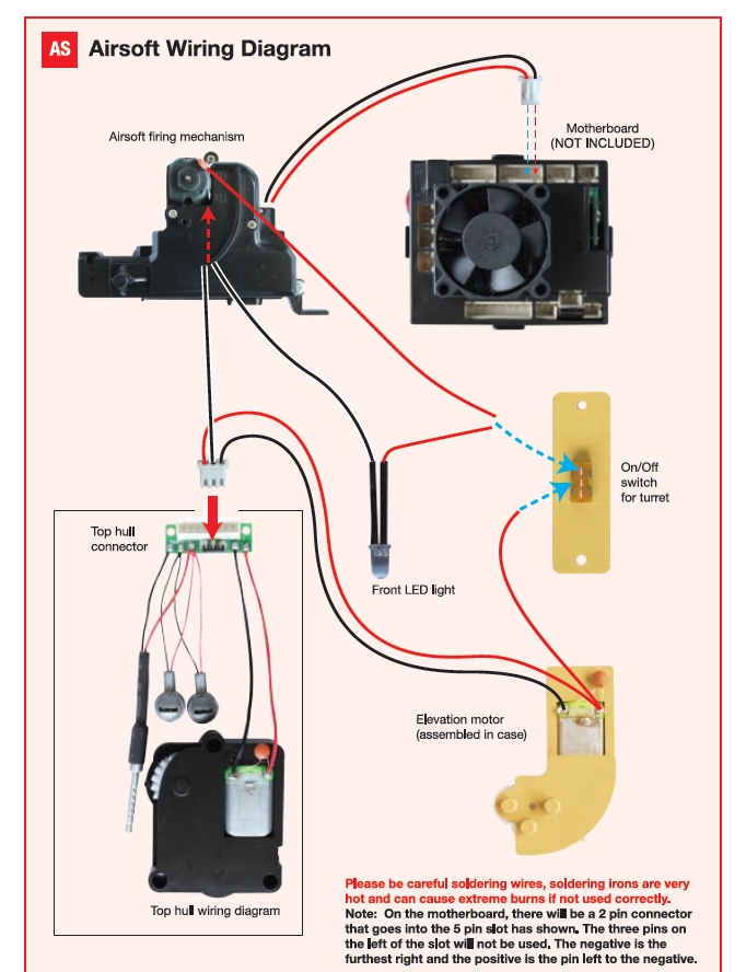

Wiring diagram for airsoft

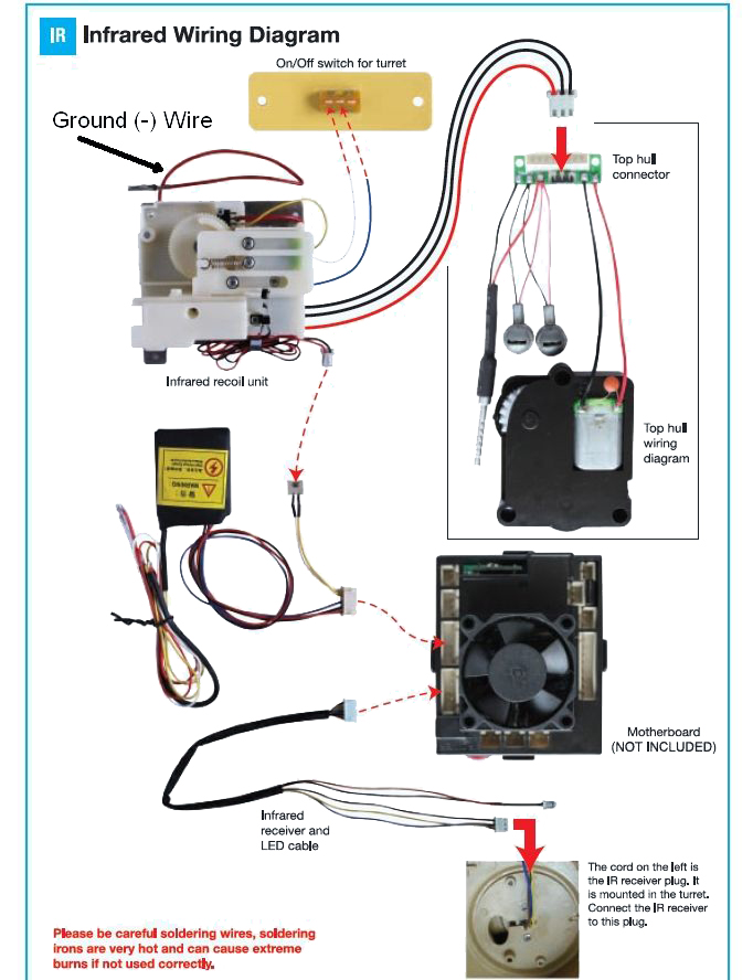

Wiring diagram for IR
Here's one for IR. Without knowing what you have, and what vintage it is, it's hard to be of much help. :think:

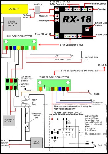

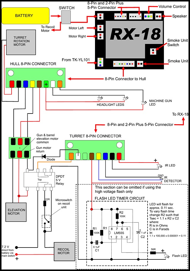

I don't think it could be V6.0 electronics, as HL have only installed the new system in the M41 Bulldog, the Tiger 1, and the M4A3 Sherman, as yet. I'm guessing yours must be the earlier 5.3 system
Here's an earlier wiring diagram for HL tanks:
Heng Long 2.6G wiring 2016
Click on pic to ENLARGE it.
One expedient would be to post photos of the tank interior, so we can see the wiring layout and MFU connectors (MFU= Multi Function Unit. On a bad day, it can be the Multi Disfunction Unit. :/ )
