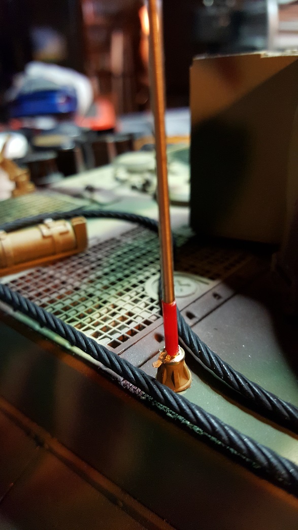

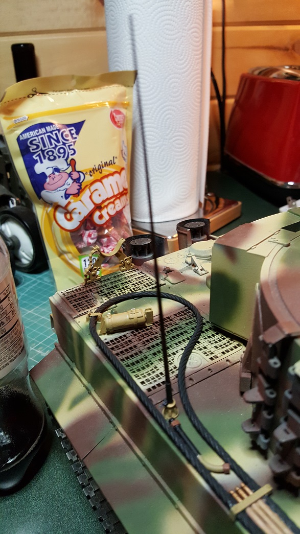

Those mounts should work for the addition of the scale radio antenna for the Tiger. The pics show the Schumo antenna mount for the Tiger 1. I have added a red rubber cover for the spring that was painted black during final detail painting.
My modification on the excellent Schumo antenna is plain to see.  It can now bend aside as the mighty 88s barrel sweeps past..jpg

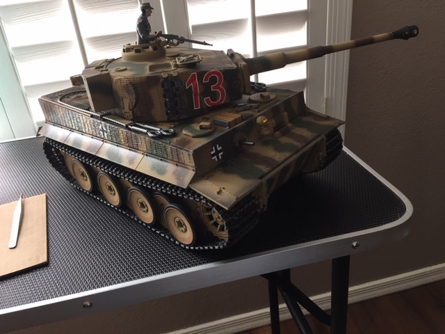

Here’s my Aber antenna and mount. Very sturdy. Kinda ugly but the harsh Russian winters play hell on the equipment.

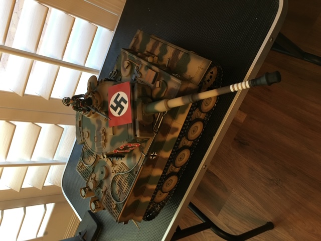

That’s the one I have. I maybe was wrong about Aber. I will say that Jarndice was instrumental in my Tiger 1 build and I advise you to heed his word for the most satisfying build result. I also recommend you scratch build the antenna tube to stand off from the deck a bit. It looks cool and is one more step towards detail authenticity.

Just an example of my humble efforts. Your later version will have the tube positioned differently so be sure to check with prototype photos of your tank. Image
I know your passion for getting details correct.
Posts: 7791
Re: Tiger I antenna mount
Good evening all,
I modded the Schumo mount. I wanted to be able to run the tank with the antenna in place and if I happened to rotate past it, not break it off. Mikes Tiger 1 ( Early ) was built the same way. My mod looks the 'part' and adds an extra measure of non-broken as well.
