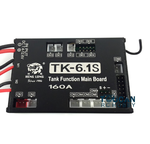

A wee while ago I found this pic on Banggood (?- it may have been another Chinese site):
Heng Long TK 6.1S
Heng Long TK 6.1S
A cursory look shows that the board can accept 7.4 DCV - 12.6V.
Then there's the mention of '160A'. I wonder whether this means the tracks can handle 160 A, or whether that's; 80A X 2; or the total capacity of the board with all functions at the max? Still, it's an indicator of some sort- if a tad inscrutable. :lolno:

I feel it’s 2x80 amps for the motors ( peak) which usually means about 2x25amps continuous. So, the controller would run a luxury DKLMRC gearbox with a big 550 easy, same for DKLMrc’s ‘normal gearboxes . And maybe also a gearbox with 2 rs540sh 27-turns beercans. ( I believe the Tamiya Leopard once had 2 rs540 sh 27-turns on board. Not sure. The motorization has changed through the times, and my last Tamiya 1/16 was the Prtl with one motor and dual clutches. Years ago..)
Not bad if that’s indeed the case with the Haya controller too, since it seems to be a rebadged 6.1s.
