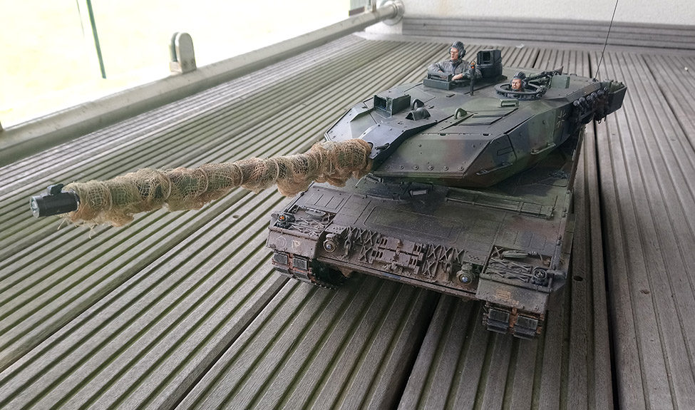

Dark grey wash and after that dry brushing with revell Matt 89 ( desert sand). The dark grey ùnder the desert sand drybrushing preserves the details, and the desert sand dampens the -for my taste- far too distinct camo colours on the Leo.
They only looked like the straight-from-the-box Heng Long when freshly washed and still a bit wet.
( when in the service, visiting the cavalry at Amerfoort ( now defunct, sadly) was a weekly thing. Seen plenty of Leo’s in varying states of cleanliness or dirt)
^ That’s the look, even if I overdid the wash a bit...

That looks just great, Jay, and the weathering is just right. She's been out long enough to get a bit dusty, but it's easy to see the girls take good care of her. What I really want to see is video of the girls washing it when they're done. Bwahahahaha

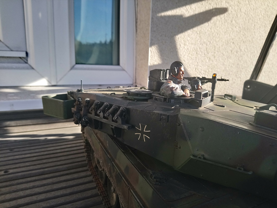

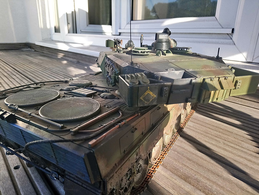

Extra tricks ( if You’re up to it) : first spray the tank in gloss varnish. Sounds weird, but here the trick comes : A wash flows far more freely in the panel lines and such, leading to nice, sharp details, when the base layer is glossy and slick. After that just cover it with a layer of alclad matt varnish, sprayed at about 1.5 bar with a 0.5 mm tip. And àfter that add the desert sand drybrushing.
On the other hand, if You want to have the wash behave more subtle and smooth, apply it on a matt base coat. The second picture, lower right of it, shows nicely what kind of blending can be reached when carefully tracing panels with a wash and then dry brush it. The more paint thinner You use in the wash, the better it will blend with the base layer.
Let dry thoroughly, otherwise You’ll rub the wash away too much during drybrushing.
I hope these tips are useful.

Looks good. I like the netting around the barrel.
