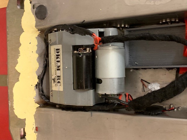

A couple of things I have found out on my "travels" - the DKLM PDSGB may struggle with the standard HL motor wires so you would be besst off getting a pre-wired board (the "W" in the board description - the thicker wires are pre-soldered rather than using the plugs). Also, if you intend using a 3s lipo you will DEFINITELY need the pre-wired board (or solder the wires in yourself!) and I am not too sure if the TK40 board will handle this. On the plus side - with 3s and PDSGB the tank moves pretty swiftly on smooth, open ground (fast walking pace - almost a jog).

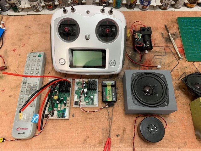

as stated here the best option would be a tk60 ore tk80. the tk 40 would lack the 'oomphh' and light options you would be wanting on a challenger .
I would probably say a tk60 spw-v3
s-sbus
p-programable( re programable) sound( if you someday maybe swopp the board into another tank
W-presolder wires( if you plan to run the metall lower hull and maybe PDSGB gearbox, ore on 3s lipo)
V3-ultrasonic ESC

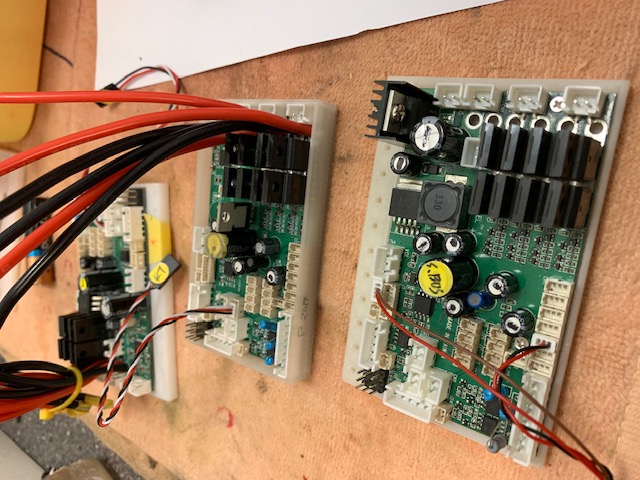

the tk80 has dual onboard amp ( 2x15 watt) but I'm not sure you would be able to take advantage of it in the Challenger lower hull. It's also powerhungry , so a
direct feed of the main battery, ore even a small lipo pack to power the onboard amp on the tk80 is advisable

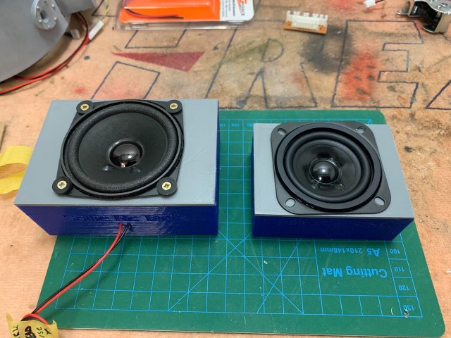

as for speakers I use the fr5( tk40) ore fr7( tk60/80) if I sell a speaker setup along with a tk board
the flysky I6S is a perfect match ( and remember to add a programing remote , so you can 'tune' the board to your liking )
