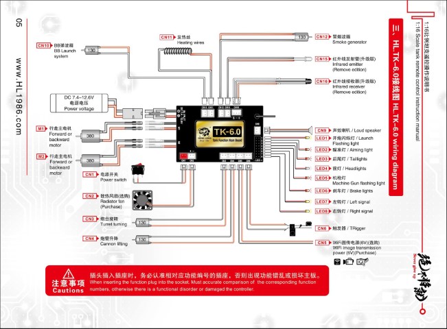

Re: Metal upgrading new Heng Long Panther G
New Heng Long tank controller TK-6
- 2019HengLong_TK6-0 (Small).jpg (85.96 KiB) Viewed 11095 times
Heng Long controller TK-6.1 . Nice improvement over the previous one.
- 2019HengLong_TK6-1 (Small).jpg (92.9 KiB) Viewed 11093 times

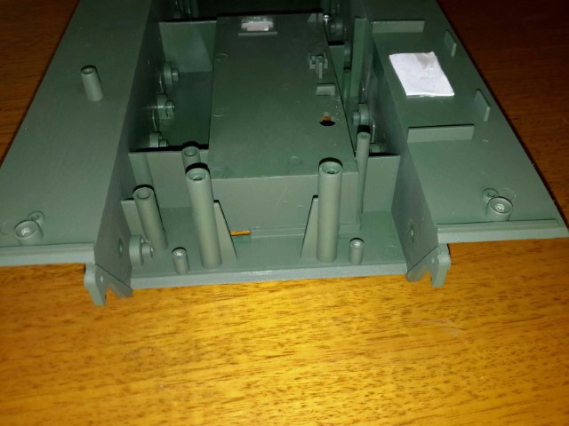

Front of stripped hull.
- IMG_20190729_135112 (2) (Small).jpg (93.8 KiB) Viewed 11092 times
Back of stripped hull.
- IMG_20190729_135025 (2) (Small) (1).jpg (89.46 KiB) Viewed 11091 times

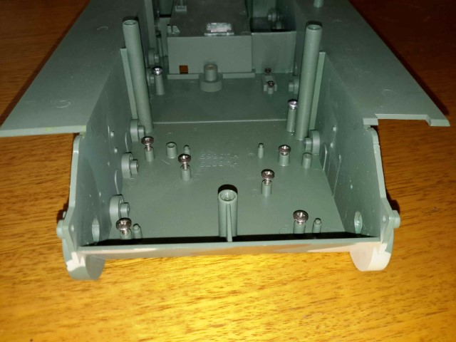

Hull stripped.
- IMG_20190729_135238 (2) (Small).jpg (93.07 KiB) Viewed 11090 times

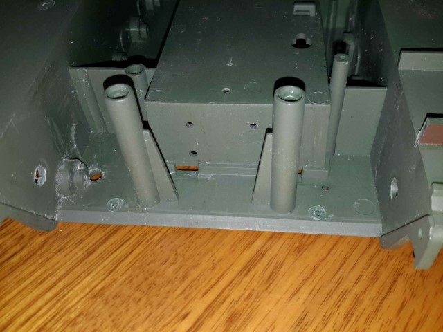

Underneath hull showing ON-OF location.
- IMG_20190729_135254 (2) (Small).jpg (92.69 KiB) Viewed 11089 times

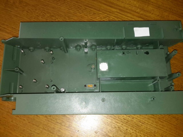

Back of hull cleared of unwanted parts.
- IMG_20190822_152459 (2) (Small).jpg (65.73 KiB) Viewed 11088 times
