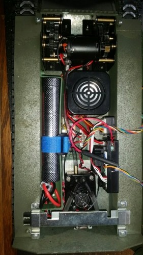

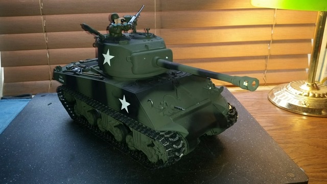

Well after a long wait, she’s finally here. Have had few week to familiarize myself with operations, controls, etc. First three pics just after receiving.
Basic insides on pic 4. Have already upgraded to GI Smokers Baroness 2...really works great using 50/50 mix of mineral oil and WD40...puts out an impressive amount of smoke. Also got Sherman sound card from UK as none available stateside and a panzer sound card just doesn’t do a Sherman justice. Will ultimately upgrade to to something better in near future.

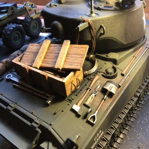

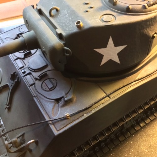

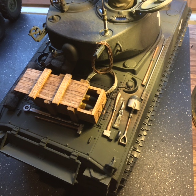

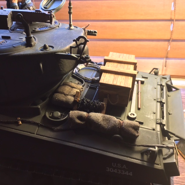

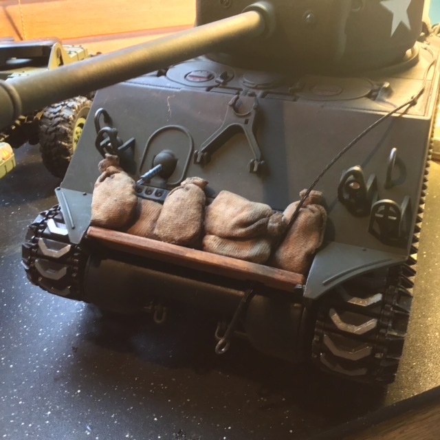

Next photo shows hand made tow cable, sands bags and wood board support. Found build thread here on forums for sandbags. Tow cable is from picture hanging kit...flexible braided steel wire with uninsulated butt splice connector attached to bent screw eye, soldered, contoured and painted.

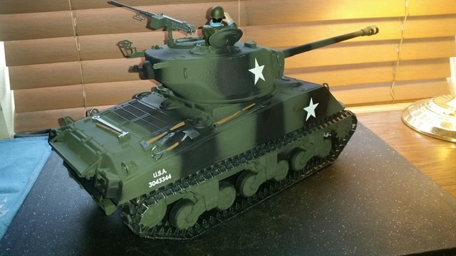

Next series of photos shows handmade stowage items...bedroll, tarp; coil of cable; spool of chain, rope on turret, and recently crafted box...(trying out some ammo inside, but a bit big for scale...think I miscalculated box dimensions).
Next photo shows diy tow cable bracket and smoke flare tube.

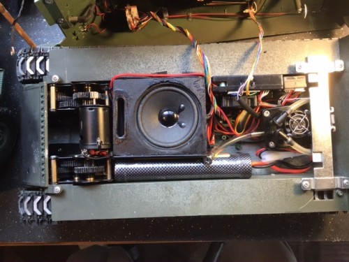

And finally, after working with small interior real estate, the after inside pic with hand made ported speaker enclosure using Visaton FRS7-S. That’s the biggest enclosure I could make even after removing battery box and verifying turret rotation clearance.

You have really maximized the small confines of the Sherman lower hull bravo
