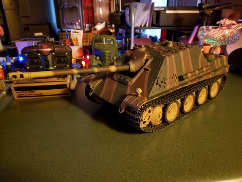

This Christmas my wife has given me a new Taigen Jagdpanther hull and a Taigen 2.4 board + controller + speaker.
With all the parts I had left from the HL Jagdpanther, I ultimately assembled my dream tank:
And the tank in action:
It has been my first totally customized tank, and everything has been done by me so it's rather amateurish but I'm quite proud of what I achieved. I just don't like how the decals look, when applying them I thought that only the graphic was being transfered and not the whole film; I will take care of this later.
The tank consists of:
-Taigen Jagdpanther plastic hull.
-Taigen metal lower hull with metal torsion bars.
-Metal wheels and tracks.
-Taigen 2.4 ghz board + controller.
-Some random metal details like the towing chains and ventilation grids.
-Plastic decorations from my old (and defunct) Heng Long Jagdpanther.
I painted the whole tank with Tamiya sprays (not airbrush) and then applied a layer of black wash. I had no idea how wash works, so I messed up a bit with it but I ultimately liked how it looks.
I added some other details like a real rope on one side (I'm sure I saw this on another RC tank and I loved it) and a random chain for some more fancy effect and I think it's pretty much done :P
I hope you like it!!!! Best regards.

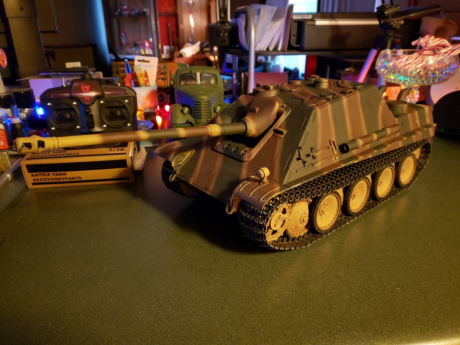

About the decals:
First apply some GLOSS clear coat there where you want them to go.
Next, cut the decals as close to the numbers as you can.
After the clear coat has dried, apply the decals, you could use the decal fluids micro sol and/or micro set, or just apply them with water.
When dried up, spray the decals with mat varnish, or paint it with a soft brush.
If you work this way, you won't see that rectangular cut, like on your pics 4 and 5.
Maybe you can take off the decals again, using some warm water (if you haven't clear coated them yet), and apply some gloss clear coat first.
Nice JP anyway, good job!

Thanks for the tip!! Fortunately I haven't clear coated the decals yet. If I try to remove them with warm water, will this remove the black washer aswel? I haven't barnished or fixated anything the paint/wash yet.
Nice Jagdpanther! Is that the Taigen one? I see it comes with metal wheels and tracks? What about the hull? Is metal too?

If you did use waterbased pain, it will come off indeed. You can repaint it after you did finish the decal job. Be carefull with the removal of the decals, so you do not damage them.
Yes, mine is the Taigen metal version Jagdpanther. Lower hull, wheels and tracks are metal. Upper hull is made of ABS.

The paints are Tamiya sprays, directly from the can. No water mix here. Same for the wash layer, I directly applied the wash with no mix of water. Do you think it will come off if I remove the decals with warm water?
Kaczor wrote:Looking great except few brass details (ropes, grill covers). In real tank they were made of steel and don't have copper / brass shine :)
Yeah I suppose!! How I can fix this? Can I just paint them?
