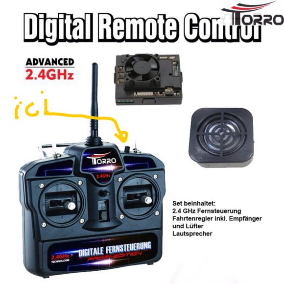

Post by Jofaur86 »
The transmitter ? Is à Torro or Taigen ? On the top rigth of the antenna there is a small black button for the adjustement of the motors :thumbup:
Looks the links Panzer shop :D détails commandes Transmitter fonctions

Jofaur86 wrote:The transmitter ? Is à Torro or Taigen ? On the top rigth of the antenna there is a small black button for the adjustement of the motors :thumbup:
It's a Heng long transmitter, this afternoon i tried all the suggestions offered on monday to no avail :| whilst testing it developed a new problem.. before turning left or right, for a moment it seemed to want to go in the opposite direction. Then the sound system started to break down, so i have now ordered a new MFU and transmitter from Forgebear. I hope this fixes the problem, as it has become a very expensive introduction into the world of upgraded rc tanks.
