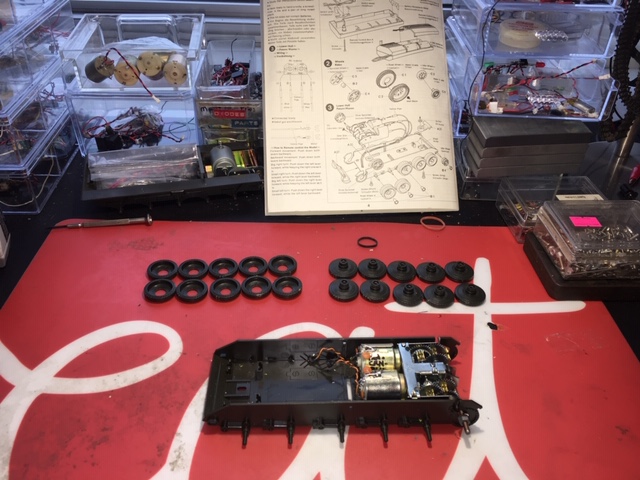

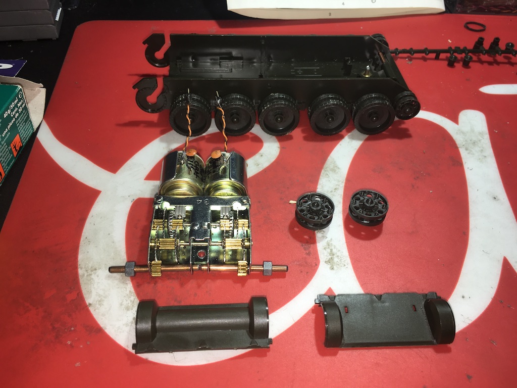

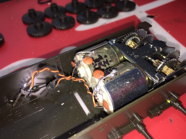

The twin motor all metal gearbox has had its motors wired and noise cancelling capacitors added and has been run in on using a Japan T-90 Tank. Motors disassembled after the first short run as these are 46 years old and the brush grease\cooling lube has gotten pretty stiff and needs cleaned off and replaced and reassembled and tested again. That why there are marking on the motors. They are ready for installation now.
Rare 46 year old all metal gearbox prepped and tuned for model operation
RRC foundation work in progress

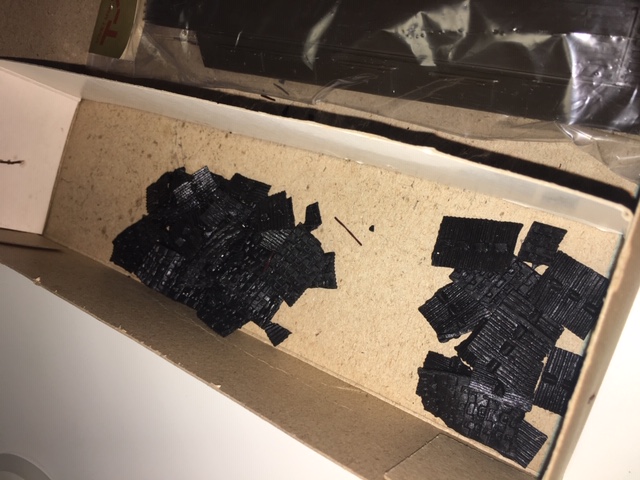

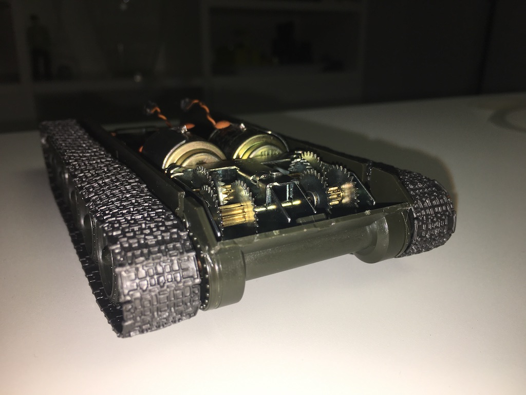

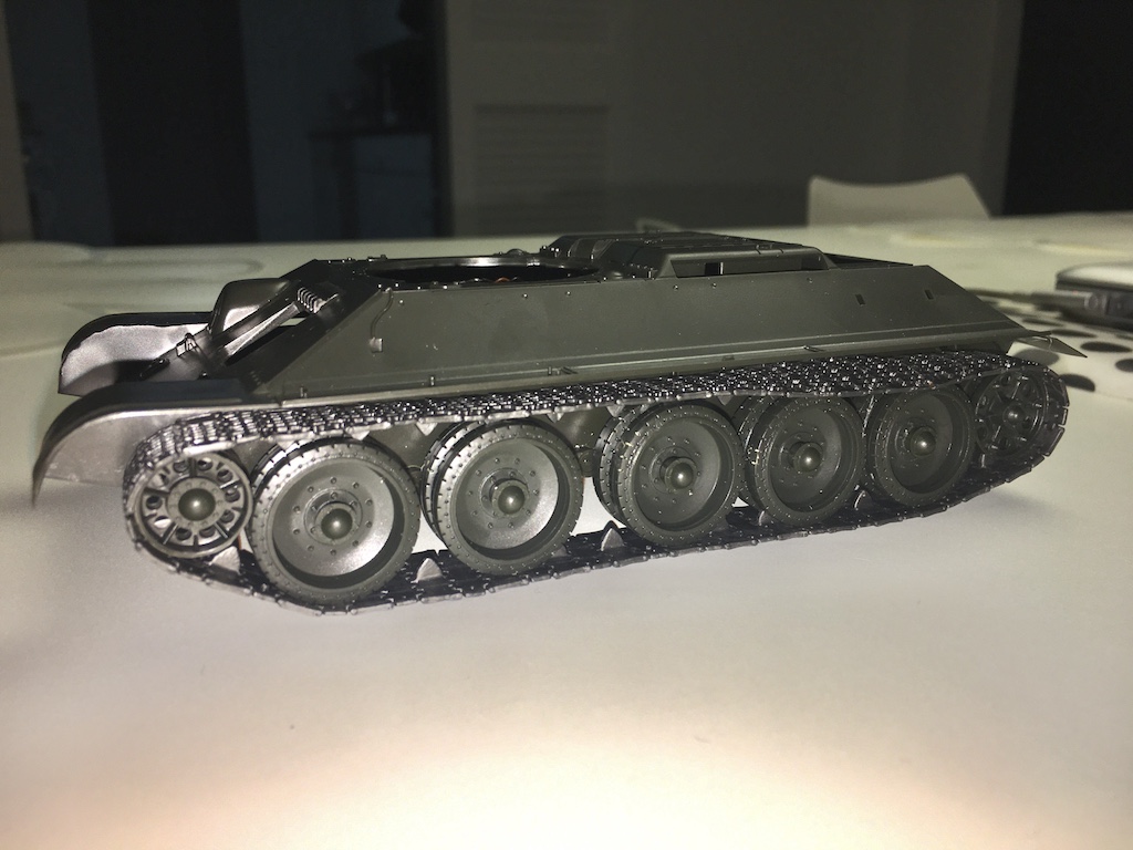

Got the chassis together and tracks installed. A issue is now noticeable with the track tension. The T-34 tracks are solid and seem a little stronger than most of the soft plastic Tamiya tracks I have worked with. Also the T-34 track sprockets are a different design from most other sprockets I have seem as they have no sprocket edge teeth. This track uses track center teeth and center sprocket drive teeth. From my experience, this type style of track drive is very stable and has superior track retention.
This tank has two track tensioners, one forward and one aft. Unusual in Tamiya models.
Hopefully these tracks will stretch a bit now that they are mounted as they are too tight at this point. They work but you can see that they are too tight as it causes some uneven movement of the track as it is under a high load due to the over tension. If required, I will manually stretch the tracks but only as a last resort. This is an unexpected issue and have never ran into this before on a Tamiya model :think:
the tracks are very tight. Hopefully they will stretch a bit. you can see the center sprocket drive track teeth in this shot.
ah, that's better. the first cover I tried did not fit with the gearbox installed...WTH? go it now lol
two different engine covers, motorized vs scale. after a little confusion, figured out there were two covers

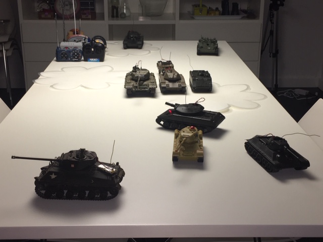

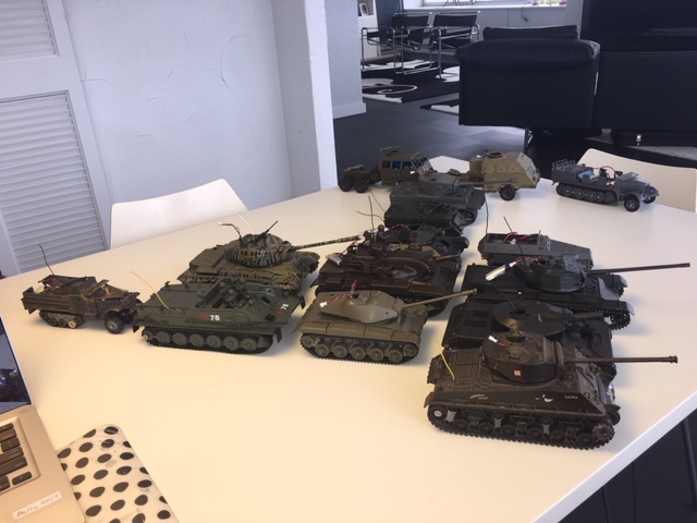

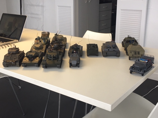

Here is more of my model RRC collection on "Table Parade" below..
Side view.
Side view.
15 models ready for today's table parade
