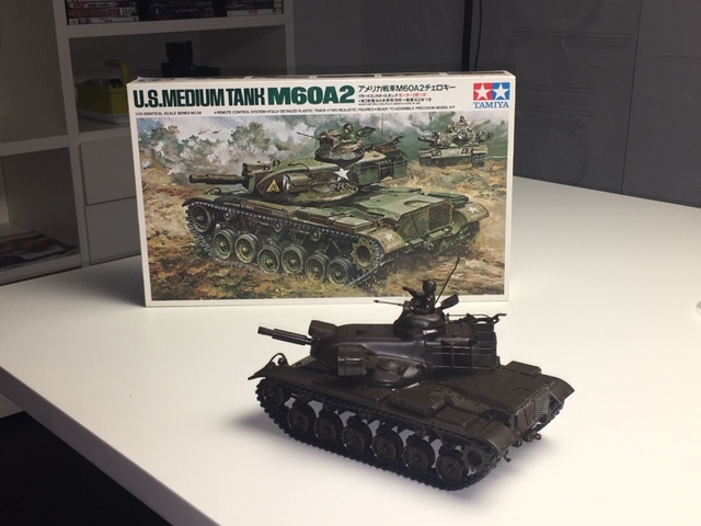

Tamiya Scale series NO.48
Tamiya, made single motor "Motorized" models and dual motor "Motorized Remote Control" military model kits. Both are all metal gearbox setups. Not sure how long they made these great kits but am thinking late 60's, and through the 70s, partly through the 80's... As a kid, I never managed to get one of the metal drive kits because they cost much more money and were rare even back then. This year a lot of these kits suddenly showed up on ebay just before Christmas 2019. I managed to get two of these "motorized remote control" kits before prices jumped to the moon 8)
The first kit I will present here is a M60A2. This kit had parts in in from 1970, 1974 So I am assuming it is 1974 vintage Tamiya kit. I never noticed before but the "parts trees" have dates on them. I have posted pictures of this below.
Now the Remote Control on these kits consists of a "wired 2 ch controller" so the model has wires coming out the back to the controller. Hey, that is all we had back then and we were thrilled to have that! Of course these days, I build these models a "Radio Remote Control" So there are now "motorized Radio Remote Control" as I present them here.
Power source 1s 130mah lipo. The stock motors are wires in series.

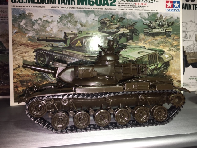

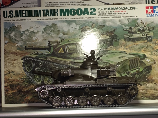

can not seem to get a good picture today in artificial light. It is very gloomy here today.

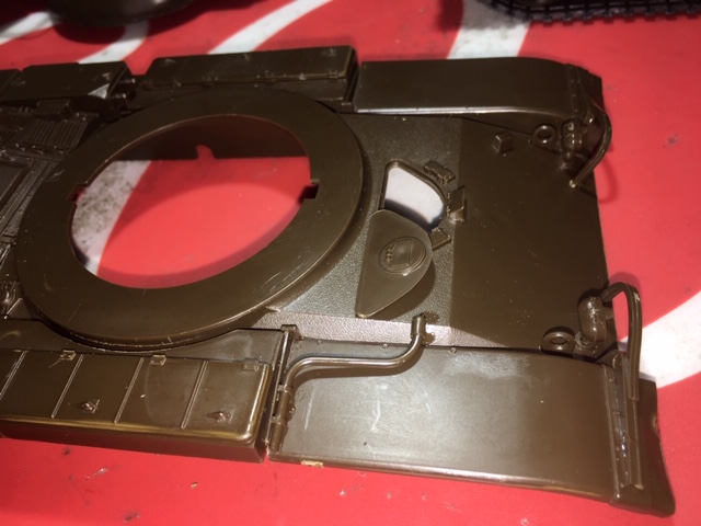

You can see the brown color here
This model is a unique color too. It almost looks light brown in color. Never saw one like this before and I have owned many of these Tamiya models.

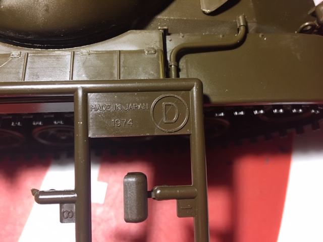

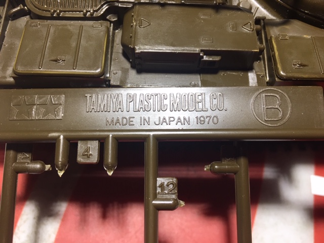

what's this, a 1974 "parts tree" also in this kit? So they used 1970 parts in 1974 to complete this kit.
1970 dated vintage "parts tree" in this 1974 kit
sliding hatch for the driver.

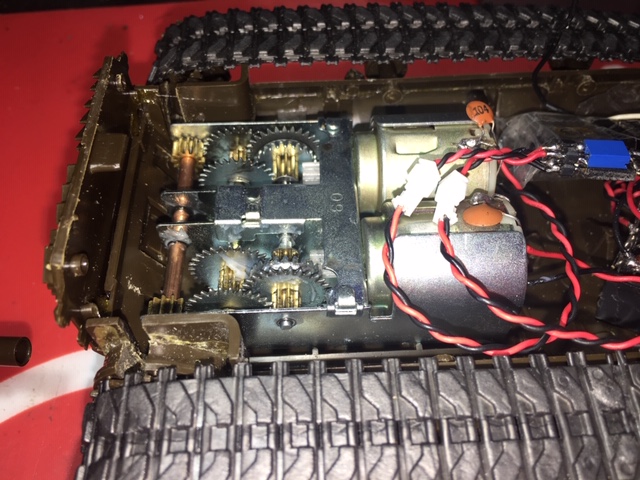

Here is the prized "dual motor, all metal gear box". They will not be making these anymore unfortunately. To appreciate this GB, Try making one of these tanks "motorized" without one and you will understand how wonderful this thing is lol

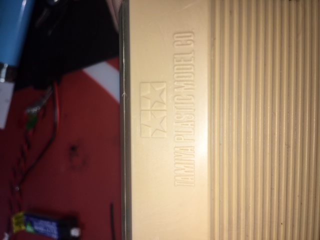

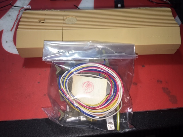

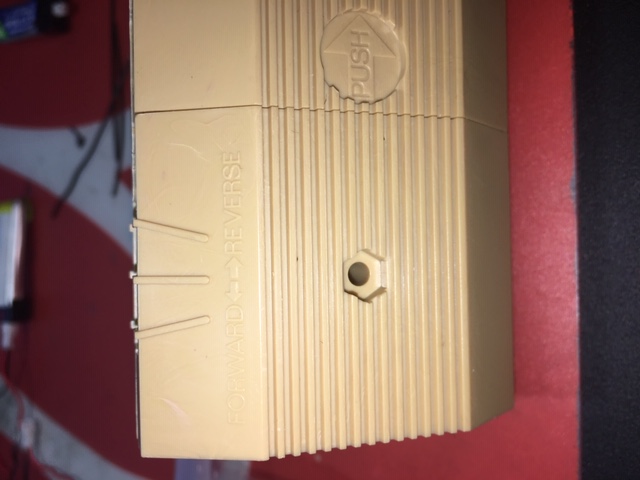

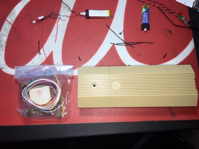

Also some pictures of the factory "remote control system"
IMG_4145 (1).JPG (64.42 KiB) Viewed 5128 times
two sides with two levers, one for each track.
You assemble the remote control system and wire it to the model.

This M60 has a custom speed control that piggybacks the 2ch radio control receiver. Here is what it does.
left stick moved forward position, Tank ramps up to Max speed, Left stick back to neutral position, Tank ramps down after a few seconds to a low speed forward, then after it travels about 3 feet at low speed, comes to a stop. So in effect, it has a deceleration with timed delay that allows it to continue forward at low speed for 3 feet before coming to a stop. At any time, Left stick can be moved down which would cause the Tank to stop before throttle time out. If Left stick held down after the Tank has stopped, it will start to reverse in direction. Right stick is used at any time the Tank is moving to steer left\right also the turns are done keeping the track in the direction of the turn at a low speed which makes for a smooth controlled turn in either direction and is proportional to the ESC speed as it ramps up and down, much like a piston engine does.
This speed control helps me when doing a video as I know where the Tank will stop after I let go of the throttle to run the camera or move the focal point of the camera which requires taking your eye of the Tank while it is moving on a table 2.5'' of the ground 8O
