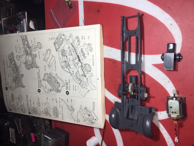

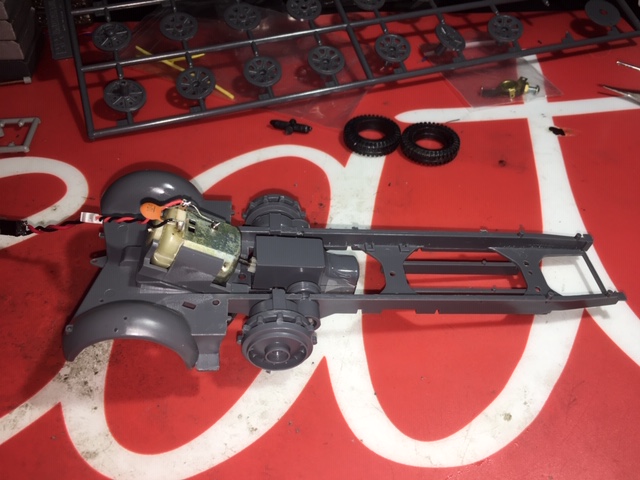

I have just started to build it up and am impressed with the motorized section.
Video of the driveline running https://youtu.be/Qv9fJPvjdF4

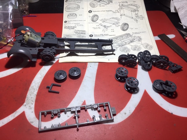

Road wheels are next.
motor and transmission in working order
The motor was so old it would not run at first but after some coaching, it started to run and now seems fine.

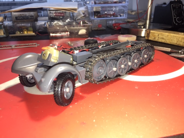

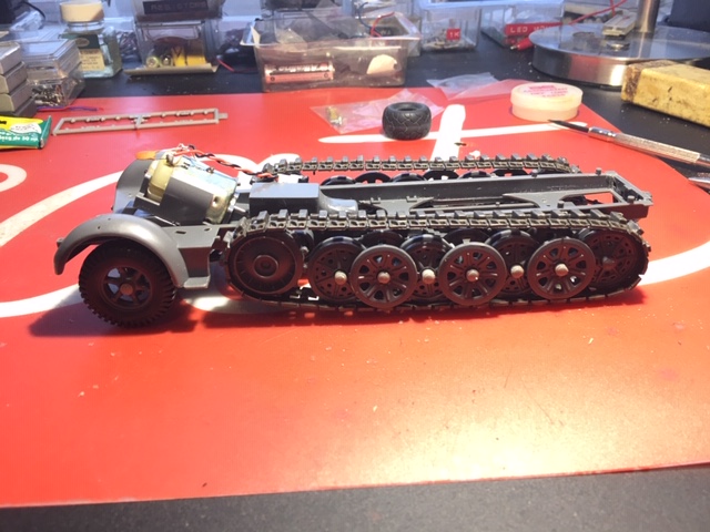

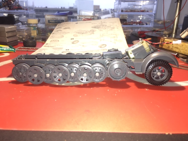

The chassis is now complete and running here https://youtu.be/L5T_AicHkwU.
I was worried that the model would have trouble steering due to the posi traction tracks (non differential) but apparently Tamiya took care of that problem in the chassis design. Even with the weight of the heavy battery over the tracks it seems to respond well to steering. My plane is to add a very small servo to the stock front end so that it is steerable via radio remote control. As it is now, the steering is adjusted manually for free run type operation as in the original design.
This thing is sweet!

Tracks installed and tested
ready to install tracks

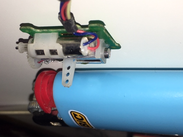

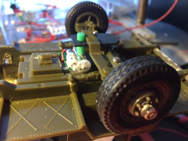

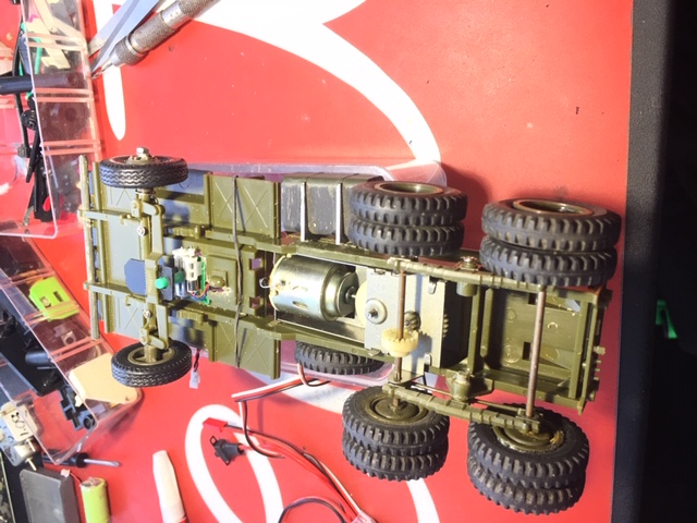

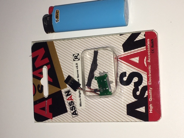

That is a good question mcq11 and one I was hoping someone would ask ;) I have only recently figured out how to do that in a reasonable manner. I have two other 1/35 factory motorized military model trucks that I added servo steering to. I think this may be the hardest part to making this scale model a full on RRC. A picture is worth a thousand words and I just did a servo steering mod on a Peerless Max M26 in the picture below.
These are the smallest servos I have at this time and they are just about right for 1/35 scale model steering.
Here is the servo I will use. They came from Hobby King, Hong Kong.
This is the first model that I have used these micro servos to add steering. I will use the same type servo on the Semi Track.
M26 motorized 1/35 Tractor with micro steering servo added using stock model front end parts

I doff my cap to you sir, I’ve just put servo steering on a 1/6 scale jeep & I thought that was hard work
