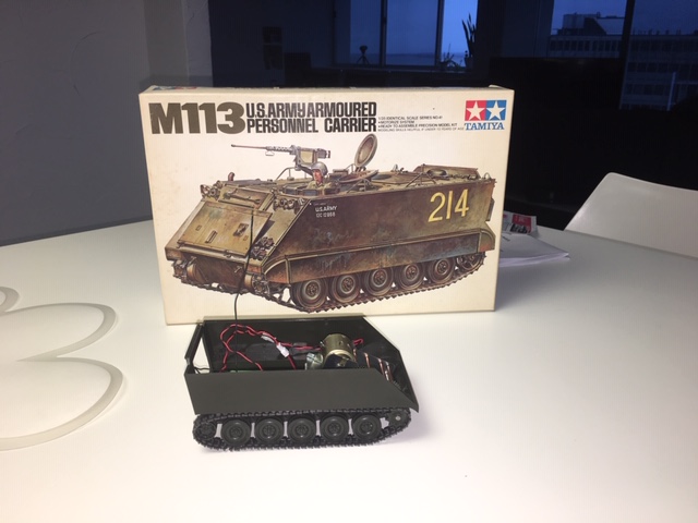

Just got this a while ago. 1974 vintage kit. I had a tough time getting it to run because it came with the wrong gear box :-< I managed to modify the incorrect gearbox and got it going. These are very rare kits (#41) So I decided to keep it and work with what was there. While working with this kit that I noticed it had a date (1974) on the bottom of the hull. Surprised I never noticed these kits have a year code. Not all just ones from the 70's and maybe the 60's. I have two other Tamiya models with a 1970 year casting.
This is a single motor kit with on\off switch. My first Tamiya kit with single motor. I set it up with a RRC throttle in this video.
It is not finished yet just a running bare bones kit at this point. I may modify it into a dual motor RRC.

Single motor motorized converted to radio control forward\reverse\stop. It is the beginning phase of this build to see if the tracks\sprockets are up to par. I will not go any further if they are not.

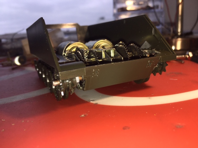

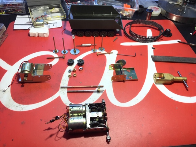

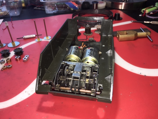

Decided today to make this APC dual motor RRC. There are several ways to do this but Tamiya's all metal dual gearbox (GB) is the prefered way to go.
Drive sprockets in the proper position for a track mount and drive test.
had to drill out the hub on the drive sprocket to size the axles, This makes the drive wheel more stable as well when the axle comes through the hub. These need a little trim.

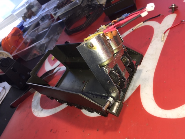

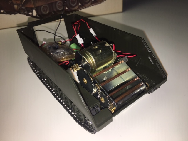

With a little work, this dual motor GB from a Japan type 74 Tank fits the APC hull. Was not sure it would fit. There are two types of these, it has to do with how the drive axle is mounted, Hi or low. This one is low.
Looking at all possibilities. Thought about converting single motor GB to dual, and that may still happen if the dual GB does not fit.

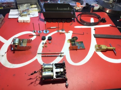

Well my dual motor conversion was a total success. The twin motor GB used came from a Tamiya 1/35 Japan type 90, I am just borrowing it for now I have had that model over 20 years and never finished it and I like this little APC right now :D
I will post a video of it ASAP. It works very well and I wonder if anyone else has converted one of these to twin motor GB. Probably not.
Anyway it will make a nice addition to my collection. I may put the single motor GB that came with the APC (M113) in something else. That GB was really for a M41 or M42 Tank and was the wrong GB for the M113.

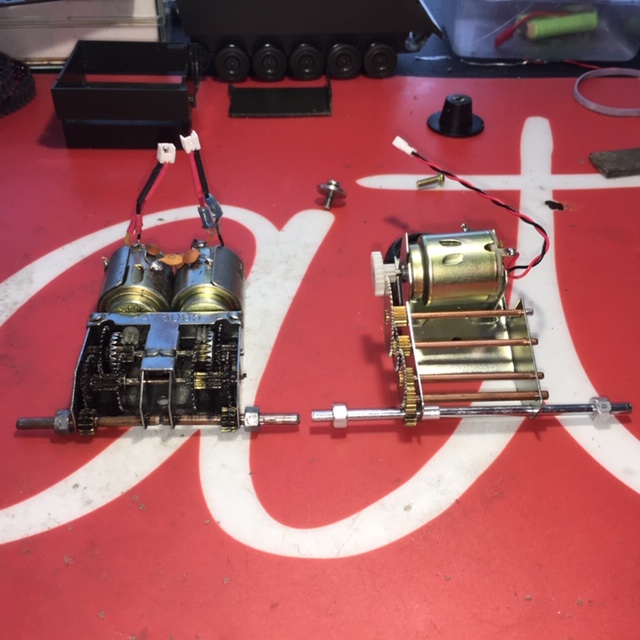

The all metal gearbox used here is from vintage 1974 Tamiya Type 74 Tank and uses the round RE-140 motors. These are slightly more powerful than 130 motors. The RE-140 motors used in this project are special 6v low speed high torque series. Can not remember exactly where I got them.

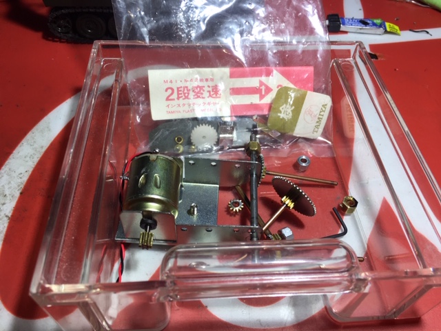

I took the GB apart thinking I was going to convert it to dual motor but that looks like an all day job. Decided to use a stock Low axle mount GB from one of my older models to get this one going quick lol.

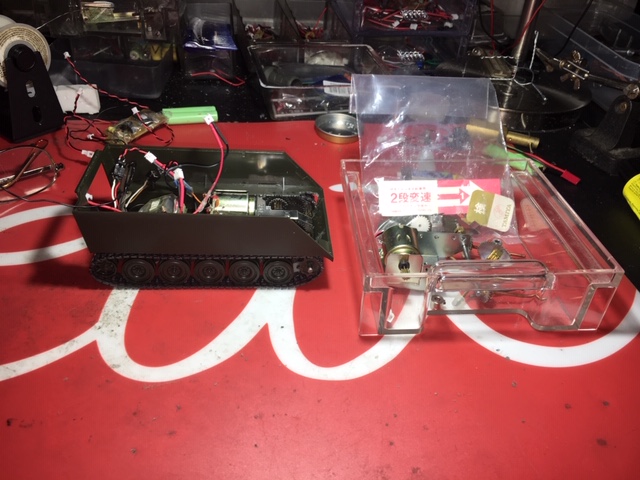

Here is the Single motor GB that came with the APC, it is the wrong one. It is a Hi mount axle type for M41,M42 TANK.
uses small 1s lipo. Not fast but very slow scale like speed. Perfect for table top operation. Uses 6v RE-140 motors.

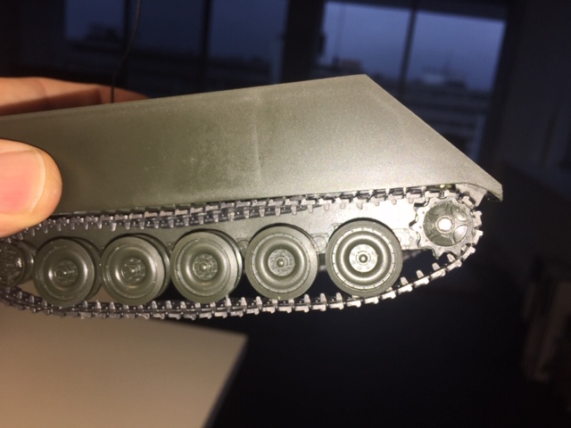

track tensioner adjustment
you can see the 2 types of what I call Hi\Low sprocket drive axle location GB, there are others but these types are the most common on Tamiya 1/35 scale

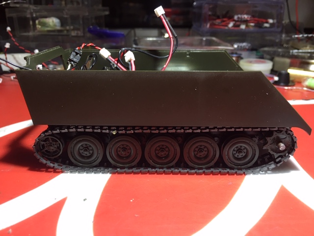

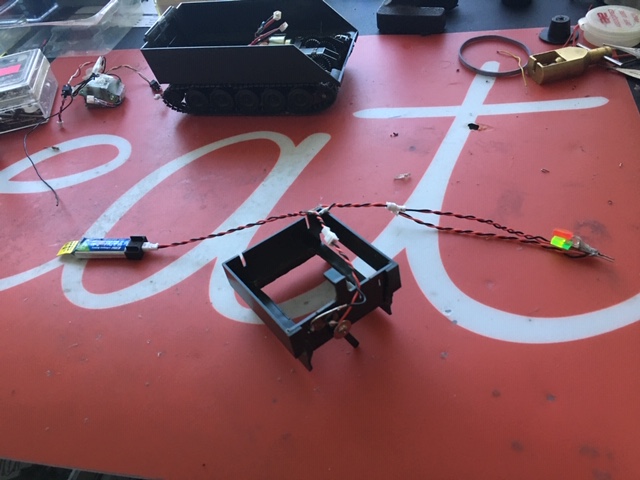

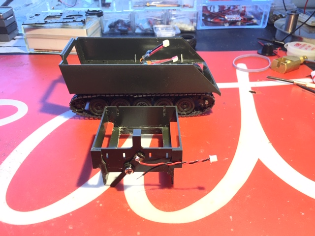

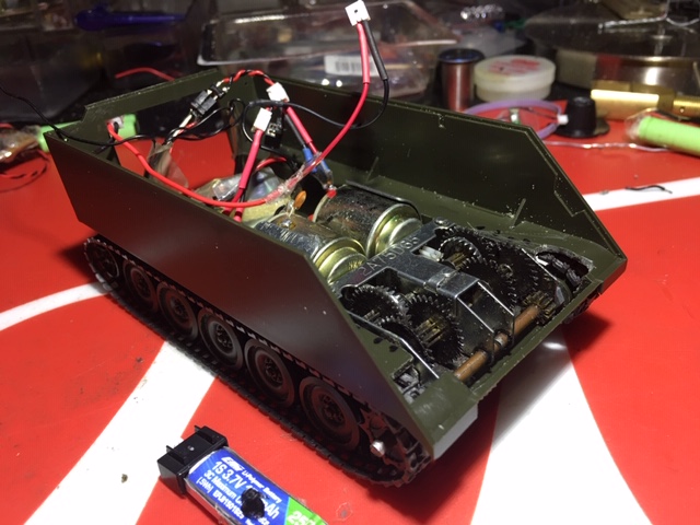

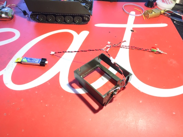

More work done on the M113 APC. In this phase the body will be assembled along with the custom wiring using the factory on\off switch.
A 1s 130mah lipo will be used for power. 6v motors rewired with noise limiting capacitors and micro polarized connectors. 2 Channel 27mhz micro receiver with programmable throttle hold (analog).
With the twin motor GB, this will be a fully functional RRC APC with FWD,REV,L,R Steering with throttle hold timer for hands off operation with a setpoint via adjustable potentiometer on the TX.
This is a s far as I got today. More Tomorrow :wave:
Testing the wiring and switch for proper operation and polarity. Green is a go!

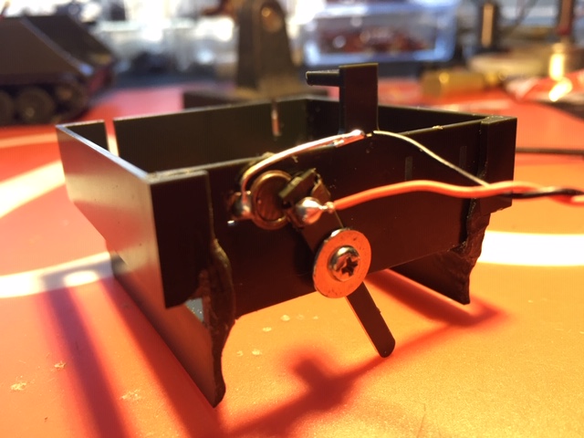

trimming and fitting the battery box. It is a tight fit in here and need all the room I can get to fit the electronics. Next two drops of epoxy to hold the box in place. It could be removed if required later.
this is the standard harness I use in most of my 1/35 scale. It connects a SPST (on\off) and a lipo to the PWM Receiver.

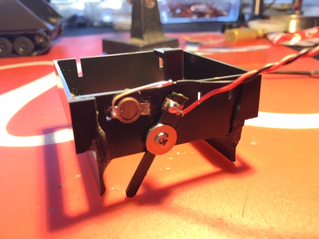

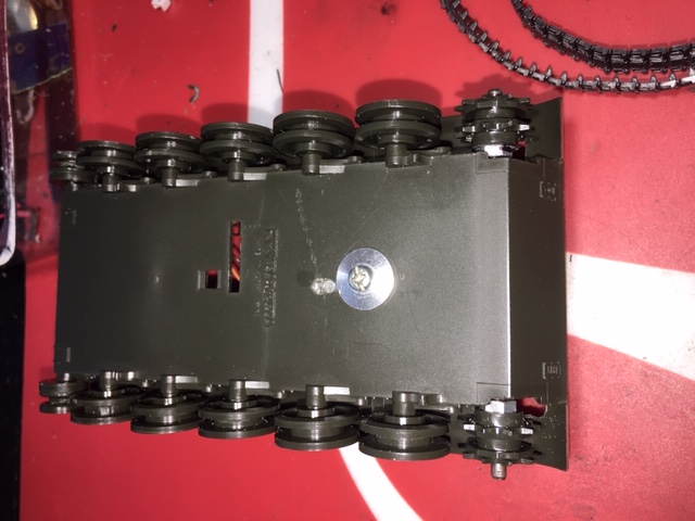

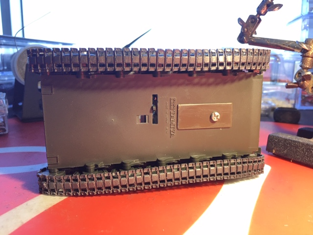

Factory switch thought bottom of hull.
Shown here in the on position.
I will be using this switch as a power on switch for an external  1s lipo so the wiring reflects that. Shown here in the off position.

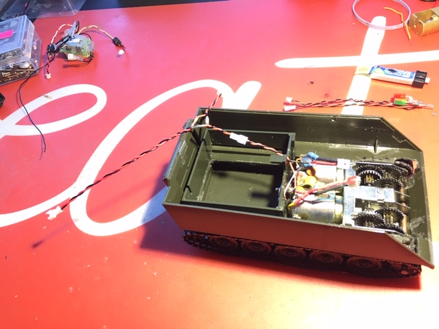

Here is a picture of the Type 90 GB I used in the M113
The battery box is also the on\off switch and latch that holds on the top of the Hull.
Single motor GB is what came with the M113, I will recycle it into another model.
dual motor GB just fits in this M113 APC with a little grinding and minor trimmings to the M113 hull.

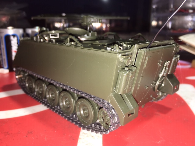

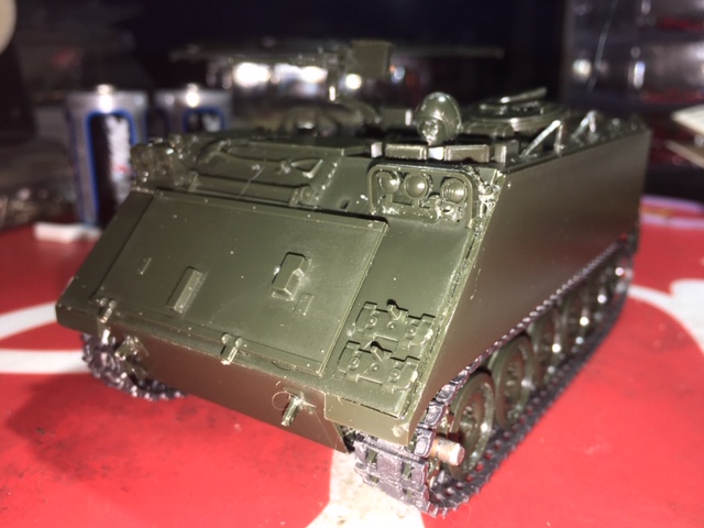

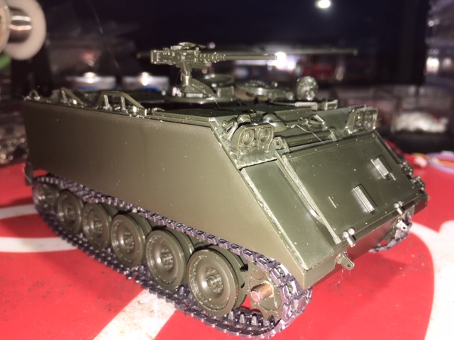

I did some video of the APC running up a 30° incline bridge but decided to finish the model aesthetically before posting a video. Got most of it done today and now trying to figure out which decal set to go with. I am favoring the German decals on this one.
Here is a short video of the M113 on my workbench. https://youtu.be/4hFd8mnA5OI
This model runs slow and scale like due to the 6v motors. With Stock 3v motors, it would be twice the speed or more. The motors can be changed out and if fact, the whole model comes apart quite easily for service\repair if needed.
Its small and scale like in speed so it can be run in a very small space. This thing is now my favorite little bug :)
I am liking the German decal set for this one.
mostly done except decals
