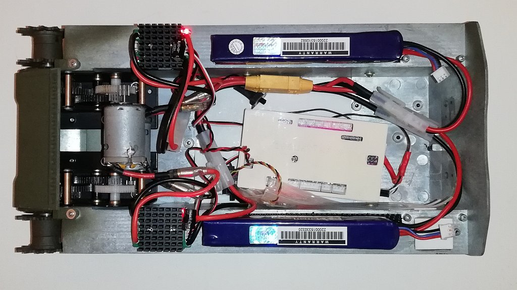

Re: New sound card.
My layout before installation of speakerjarndice wrote: The Sherman in common with the Panzer 111/4 suffers from limited interior space which controls what can be fitted inside although using "Velcro" to line the inside of the Sherman helps to make maximum use of the available space. The judicious use of Cable ties also helps to make more room.
Re: New sound card.
Volume is fine, just looking for a more realistic Sherman sound without having to get too technical.
