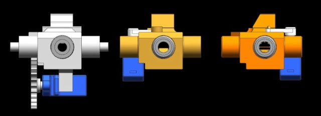

There are images regarding the size comparisons... (Stolen from Can-AM RC Tank Club forum...)
As Installed in the JP.
The universal version by JCC is finishing trials and getting tweaked for final production...
Clark Clone (upper, T-34 mount) and JCC Compact sold at Forgebear (lower, Jagdpanther mount)

If you have any Q's about the JCC Compact recoil unit, drop me a PM.Soeren wrote:Great thread. Didn't know about the units bust ordered two of the cimpact version. That is exactly what I needed.
One note on the JCC Compact recoil unit. They do not work with stock rotating side elevation units (Stug, Sherman, Panther, etc...). You will need to use the servo tail and individually tailor the linkage/throw to get the desired gun barrel elevation/depression.
The new prototype of the JCC Universal (shown being part of the M41 above, and the design models above) will work with those elevation units.
