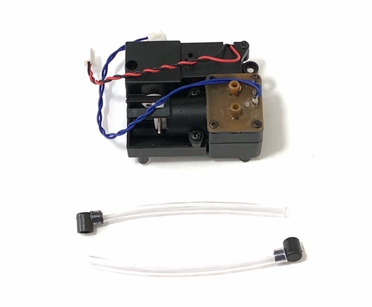

This is the Heng Long smoke unit for V6.0 MFU's, according to the Haya site. On the face of it, I can't see that it differs substantially from other smokers with two connectors. :problem:
V6.0 HL smoke unit
V6.0 HL smoke unit
V6.0 HL smoke unit.jpg (44.88 KiB) Viewed 2318 times

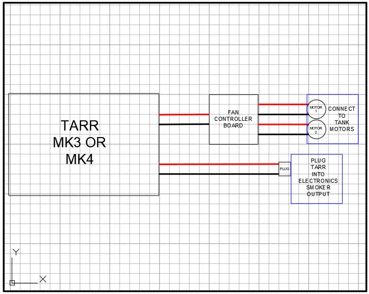

The Tarr Mk 111 Pro and MkIV pro units work with versions 1 and 2 of the Taigen control board; but not V3. Vs 1 and 2 had two sockets on the MFU for smoke units (on/off and smoker output). V3 only has one.
That has to be significant. Incidentally, here's the wiring array for Tarr 111 and IV Pros:
(from rctankelectroncis)
Tarr Mk 111 Pro and Mk IV Pro smoke unit wiring
Rctankelectronics-Tarr wiring.jpg (61.76 KiB) Viewed 2284 times
The different versions of the Tarr unit vary quite a bit, but- I think I'm right in saying- that 'proportionality' is dependent on the unit being wired directly to the drivetrain motors. This is not the case, however, with Taigen smoke units. The sense of increased speed seems to come down some other trace on the PCB.

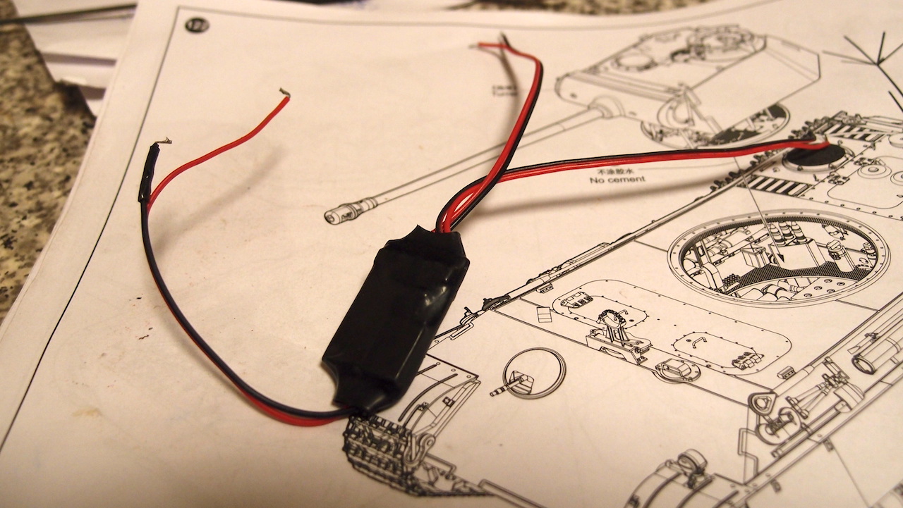

Have this , a picture is worth a thousand words. Bought this and now cant remember what its for might be for an HL smoker. I gave up on them as Tarr was quieter and the heater worked for far longer.
