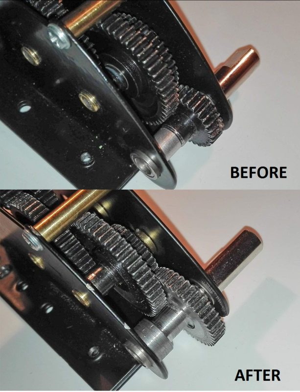

NIce, realistic crawling. BUT doing it only by electronics could cause problems (as stated above). First things to change are gearboxes. In my Sherman I have last gear changed. Now it have bigger torque and less power consumption.
- Clipboard02.jpg (85.47 KiB) Viewed 1940 times
