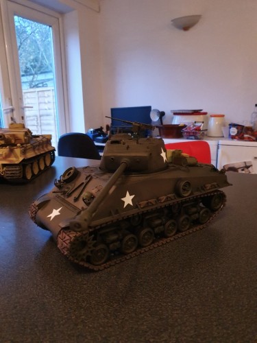

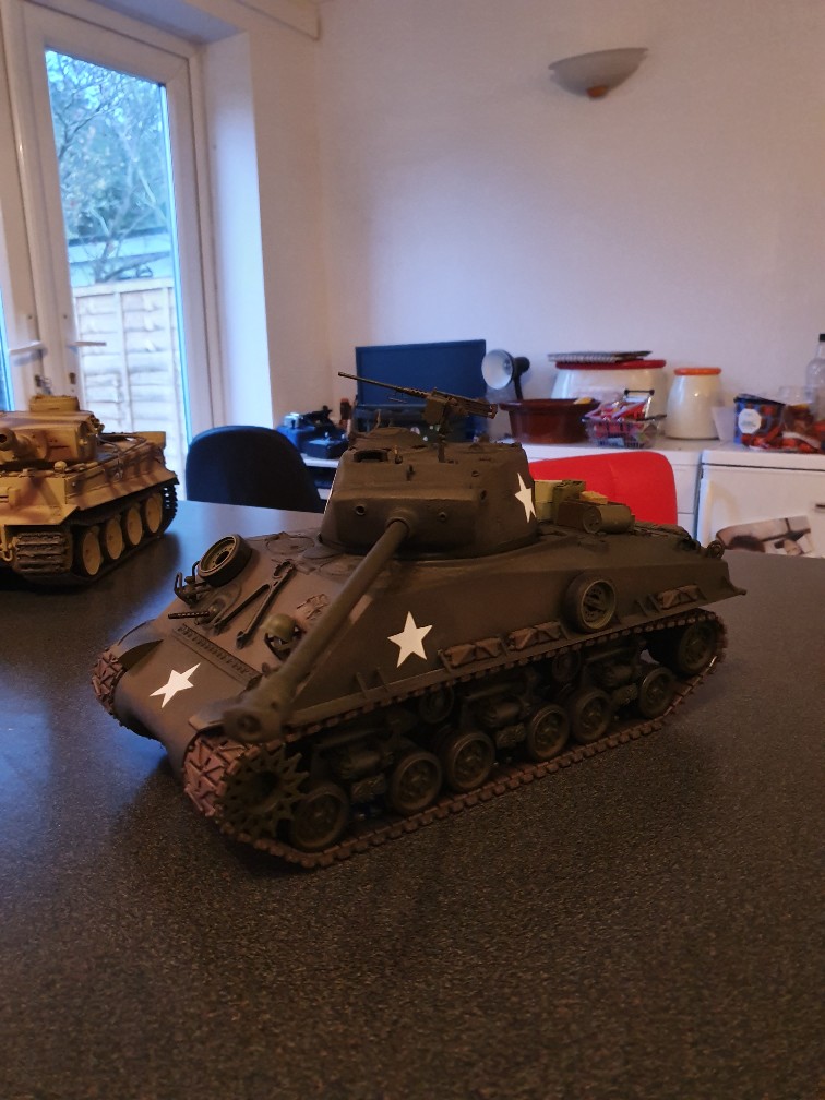

Bought this off of Ebay for a bargain. I managed to get the gun to elevate but It doesn't have barrel recoil. Any ideas how I could install barrel recoil?

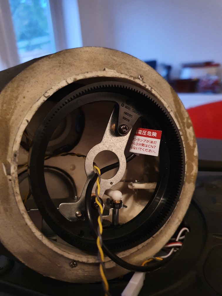

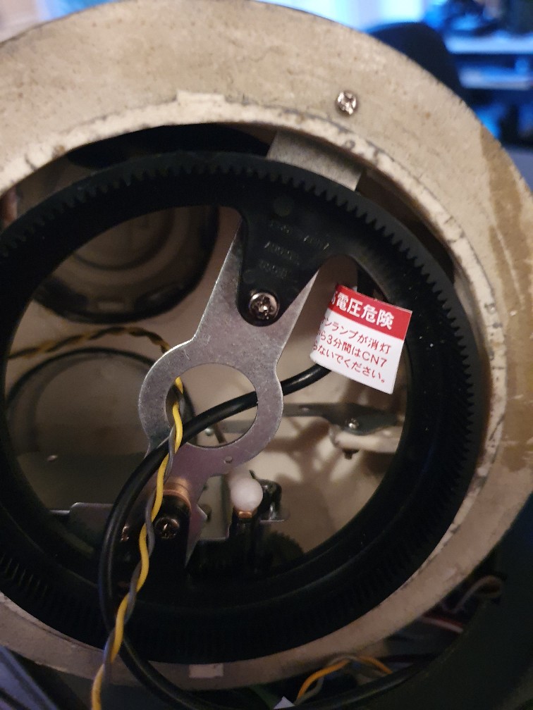

That’s a Nick Aguilar resin turret by the look of it.
I installed recoil in mine and no elevation, obviously they installed elevation and no recoil. It’s a. Erg tight fit for both.

I bolted a Tamiya recoil unit to that metal bracket at the turret base - sadly all of my pictures were lost on the great Photobucket debacle

Cheers guys, I'm going to remove the elevation as there isn't much movement any way and get a recoil unit, project for over the winter :) I think I might have to get a new barrel as there isn't any of it in the turret to attach a recoil unit to.

Knock the barrel out and line the hole with some brass tube - assuming that whoever assembled it hasn't glued the 2 pins in that hold the mantlet in place...
Failing that I can PM you the original manufacturers contact details, he'll be able to supply replacement parts.
