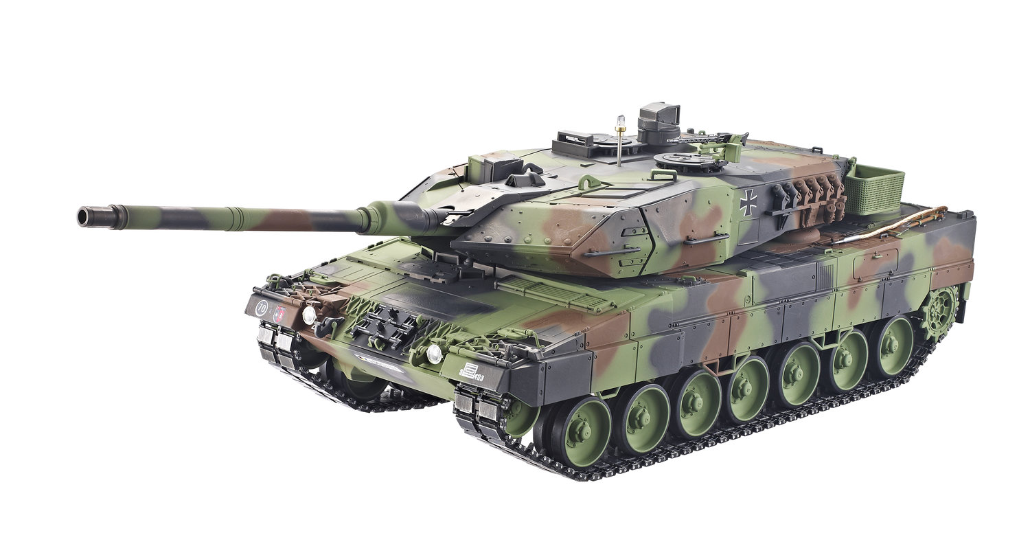

The Leopard cropped up earlier this month in a thread. However, I was wondering whether the Heng Long 2A6, but now equipped with the respected V 6.0 electronic heart, might be better value than the Taigen V3 equipped models?
Here's the Taigen:
Taigen Leopard 2A6 V3

Since there are several equipment levels, and concomitant prices for Taigen versions, ranging up to £500 for the model that includes the wooden tank sarcophagus, and the HL model should be between £150-£200 ( a Shade over 200 Euros on rctank.de), wouldn't the Hl offering seem like a bargain?
Other questions come to mind here:
1. pros and cons of HL v 6.0 vs. Taigen V3 electronic controllers. Which set will give best results overall, and why?
2. Accessories provided. Who provides the best package, or are they the same?
3. Are the shells produced in identical moulds? If so, it might be more fun, and cheaper, to customise the HL than buy a fully enhanced Taigen? Even though the Taigen is decked out superbly?
4. Does the metal hull for the Tiagen fit the Heng Long upper with the same ease, and without mods?
Somebody is selling the HL Leopard 2A6 on Ebay for only £134, and it's advertised as 'V6.0. But, I wonder if it is, since none of the pics indicate the version, and this bit of text looks a bit suspect:
