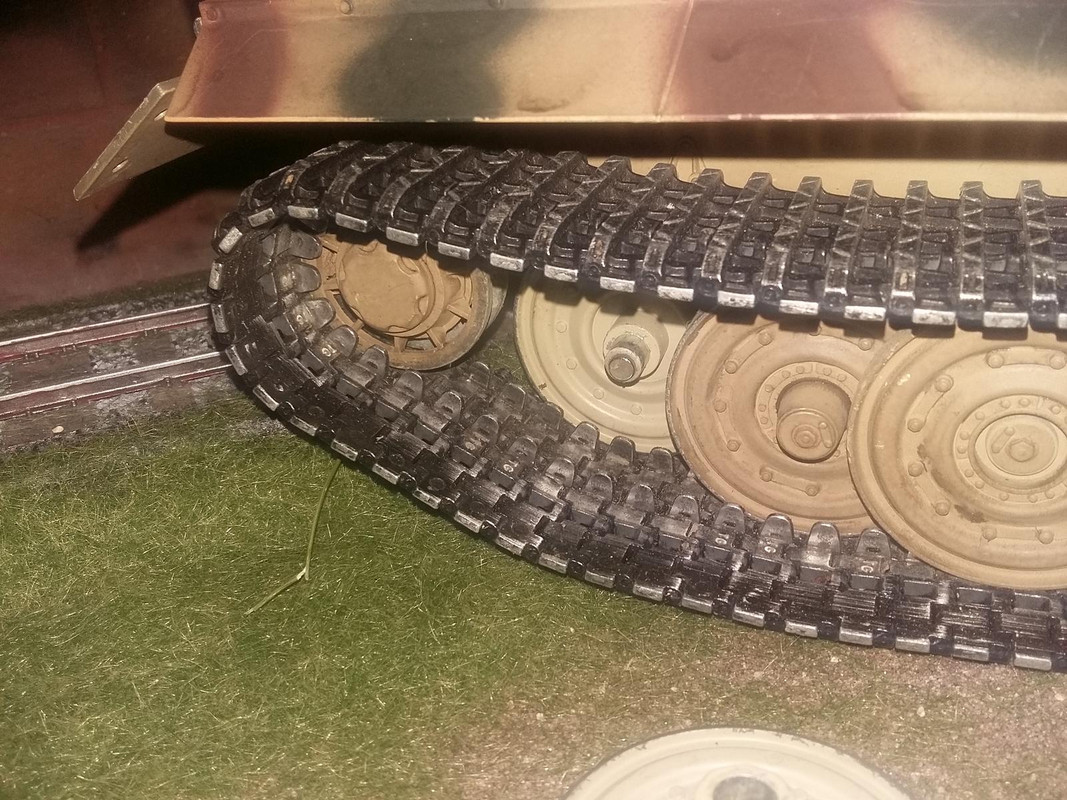

Hi everyone, I would like to know how the free wheels of my Taigen Tiger 1 full metal are fixed, now there is one that does not hold up so well. What can I do to solve the problem?

Could you clarity - how the wheels are fixed to the suspension arms or how the suspension arms are fixed to the hull or how the suspension operates?

In practice the roard wheels I speak of those mounted in pairs seem to be kept by a magnet? Today taking a ride with the tank I found a road wheels on the ground, but you can't see any screws that keep them together, it was enough to put it back. I hope I was clearer

I have a Torro Tiger1 with Metal Wheels and they are held in place by stainless steel "HEX" headed screws.
These screw into the lower part of each Suspension arm.
I have never heard of Tank wheels being held in place by Magnets.

Agreed! It sounds as though the retaining bolts were missing. Are they fitted to the other wheel axles? Did you buy this new?

That looks like a bolt has sheared off?

But are they kept under pressure or with a magnet? However for the price of the tank I am very disappointed ... I use it really very little. Taken again on rctank.de

Bolts keep things in place by screwing into a threaded hole. No magnets!

These are late roadwheels. Never seen in life. I guess you should report this to rctank.de.
