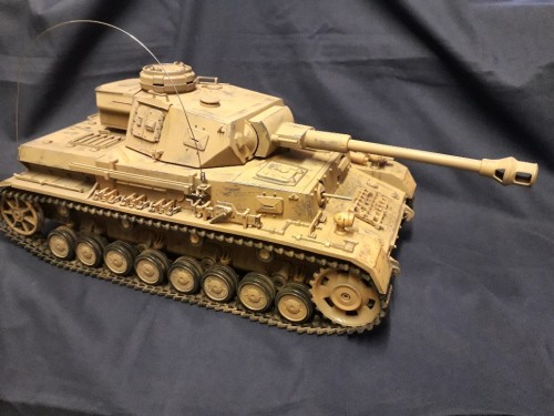

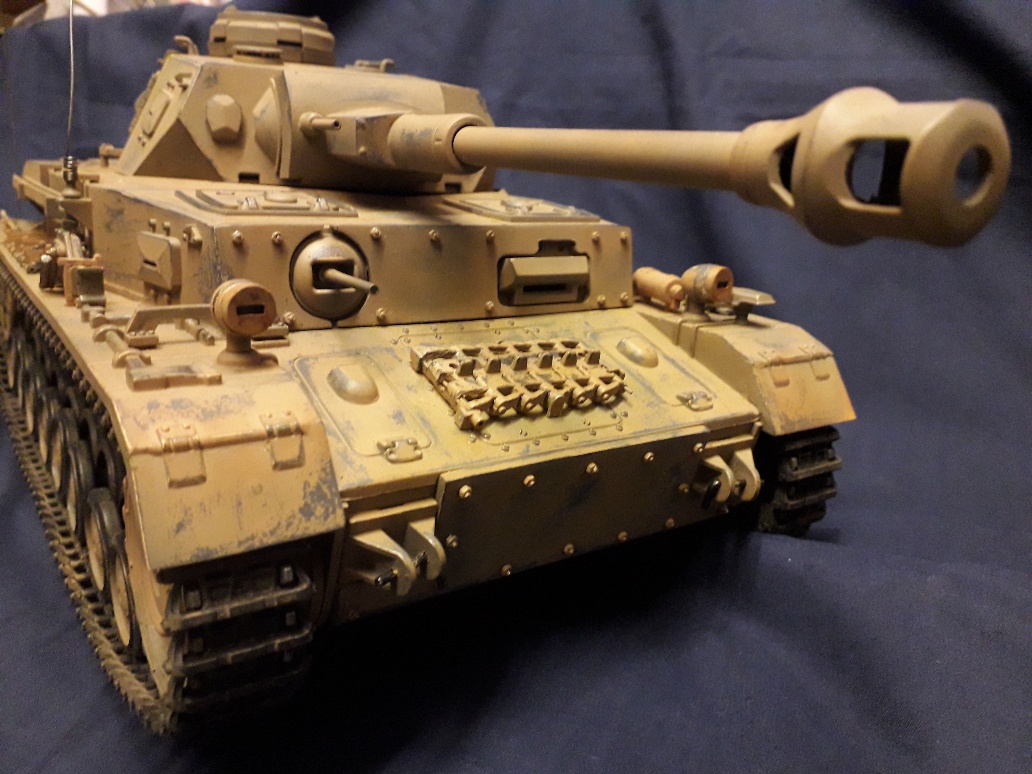

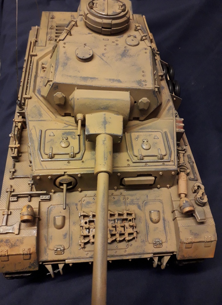

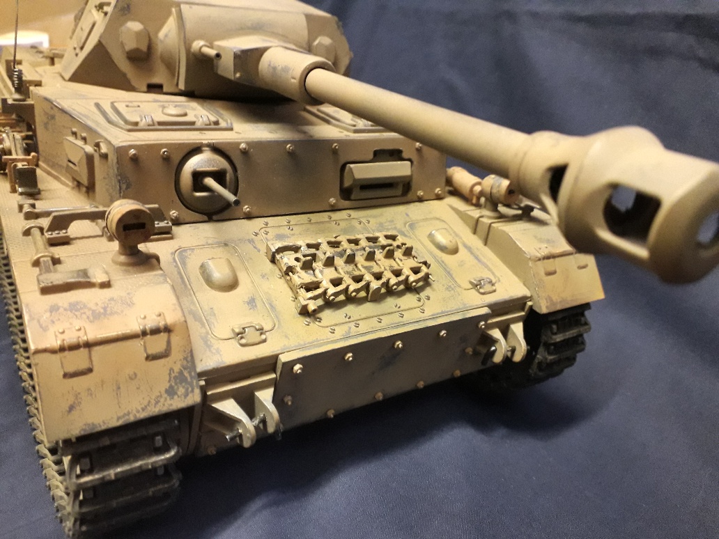

Hi chaps.
First of all all you P4 experts be gentle with me, here is my work in progress of my modification from a scrap Heng Long P1V D short barrell to my interpretation of an Ausf G with 75mm long barrell DAK
The gearboxes were scrap and have been replaced the plastic sprockets wouldn't come off the axle ( allen screw hole too shallow ) so had to break them to remove the gearboxes, my mate gave me some surplus gearboxes and some P3 alloy sprockets which were fitted, these were slightly bigger in dia so had to remove the front mudguards and modify them with fillets to allow for track clearance.
The hull mg was made from brass with fibre optic cable for flash. The barrel made from brass and the muzzle break modified from something else.
The mantlet was removed and totally modified to correct size and shape, viewing slits opened up etc, the mantlet couldnt be moved closer to the turret face due to the bb mechanism which i still wanted at this time
Turret bin lowered and modified and headlight covers scratch built
Radio aerial moved from rear to rh side
Further mods in time will be diy barrell recoil, muzzle flash and mantlet moved closer in.
Painting is airbrushed and weathered by me, still not finished yet...bit more weathering and decals for Africa corps
Radio is still stock 27 Meg...
Model shows additional scratch made bolt on frontal armour with 12 BA nuts etc.
I wanted a well used P4 thats seen a few sand storms.
As i said still more to do until im happy.
Regards
Sub.

:) No quibbles, so far. :thumbup: One bugbear for me, with non-Tamiya upper hulls, is that the rear engine deck should have a slight slope in it, where Taigen/ HL/Mato have it annoyingly level. It's a bit of a job sawing slight fillets oot to create the slope, but long term, it makes the model much more authentic looking. :thumbup: It only costs elbow grease, and a bit of careful cutting.

I was aware of the rear deck slope but didnt do it for fear of beggering it all up, but food for thought for later, the barrell indicator is to be fitted shortly and on the list of things to still do.
It runs quite well with the P3 sprockets as being slightly larger they gear it down a little more and is very smooth, i did have to add an extra link each side to account for the extra length / diameter.
I will add / alter more as time goes on and make parts that are needed, thx for all the detailed info on the P4, i have the Panzer 4 at war book which is quite useful.
