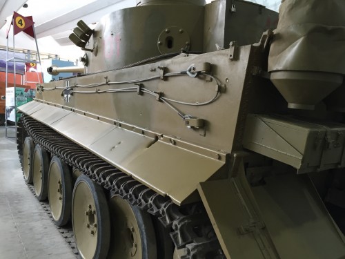

Here's a pic I took of 131's track guards/fenders. Apart from a couple of shrapnel scars, you'll see they're otherwise straight, with no visible evidence of distortion.
You've certainly made a praiseworthy attempt at 131's (barely) two-tone camo scheme. I'd guess many visitors to Bovington only see the base colour, but you've added that elusive secondary shade, and with the same subtle touch that the original has. :)
