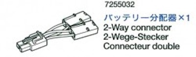

A second query: has anyone an idea why Tamiya Tiger 1s appear to require two batteries, where other models are supplied with a two-way adaptor enabling both DMD units to share the single battery?
Why should it need two, when the beefy KT can get away with one only? Does it really make any difference :| ?
Tamiya 2-Way battery connector
2-Way connector.jpg (12.66 KiB) Viewed 6218 times

I swap my Tamiya Tiger and King Tigers over to the two way adaptors :)
