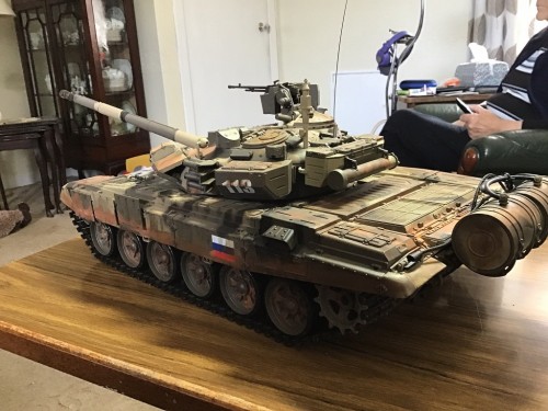

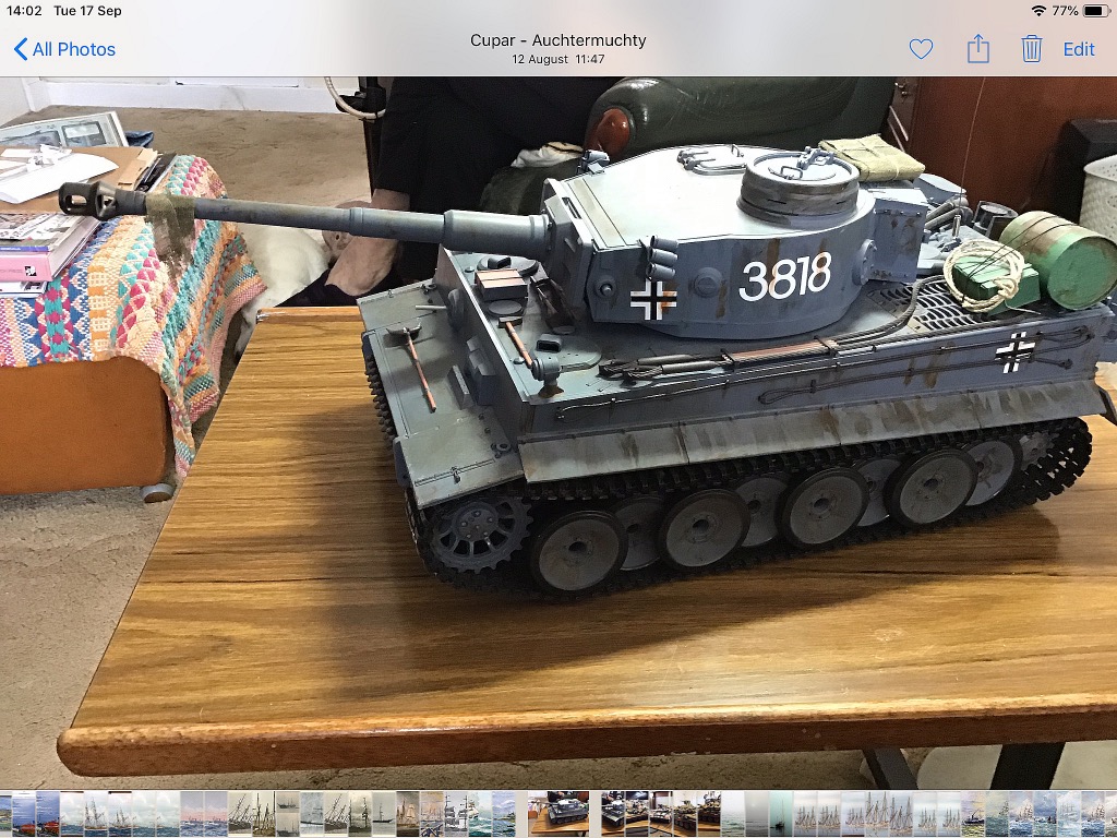

Two tanks at present HL Tiger1 and T90. Other 'hobby' painting in Watercolour, mostly ships, although I have done a couple of Tanks.

Welcome, both good looking, as is your painting, the paintings at bottom of tiger photo look very interesting.

Very cool. I see I'm not the only one that needs to take that 4-Digit number off my tiger. The Germans only use three digits on the turrets of their tanks. I believe the first digit was the company, the second digit is the platoon, and the third digit is the tank number. I think.

Vega/Jim Welcome to the Forum
Max has very gently pointed out the B Awful Heng Long decals,
We all learned after listening and researching our Tanks that the best place to put them was in the bin
They are almost all inaccurate and look wrong..
Peddinghaus is one supplier who makes some very accurate ones,
As to the Tank, Heng Long and Taigen have for as many years as I have been putting up with them sold the Tiger 1 with a number of Basic mistakes,
Two of those mistakes are clearly on view the first is the Cupola,
It should be remounted with the Cupola Hatch hinge in the 20 to 8 position looking from the front, This will bring the commanders viewing slit to the straight ahead position,
The cupola comes from Heng Long lightly glued into the wrong position but inserting a blade in a viewing slit and gently I SAID GENTLY lift the cupola, , now do the same in the opposite viewing slit, You should hear a cracking noise that is the glue failing, continue until the cupola is free.
You will notice that the base of the cupola has a slot which fits over a retaining knob,
That knob is in the wrong place as the actress said to the young virgin,
File it down and replace the cupola in the correct position, I would not glue it down this early in your ownership of the Tiger,
The other failing is the Duplicated Aerial Stowage Tube,
Apart from the Tiger 1 Command Tank there was only one stowage tube and that was on the right side of the engine bay, (Left and right are taken from the drivers position looking forward),
If you get the blade of a craft knife under the end of the faux tube at the front and start cutting to the rear you will discover it will with a little persuasion peel off in one piece.
Trust me within weeks you will be more skilled than a Brain Surgeon while working on your tank.
The glue on the Decals is not that strong so if you can get a thumb nail under an edge you should with care be able to peel them off,
You will need to wipe the glue off with Acrylic thinners.
I am sure you will have lots of questions , We enjoy answering them
