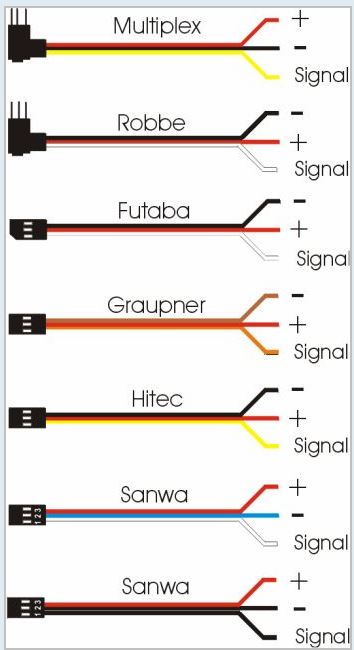

Re: servo wires
Hello
Principe finctionnement servo
https://fr.m.wikipedia.org/wiki/Servomoteur
Nrmalisation selon marques
- jarndice
- Posts: 8431
Re: servo wires
That is a useful table which is now on my Favourites list, Thank you.

Re: servo wires
Well, this has been a learning experience for me. This is the first time I've ever seen Servo wires where the middle cable was negative, but then, my only RC experience is with tanks and trucks. Good stuff, guys.
