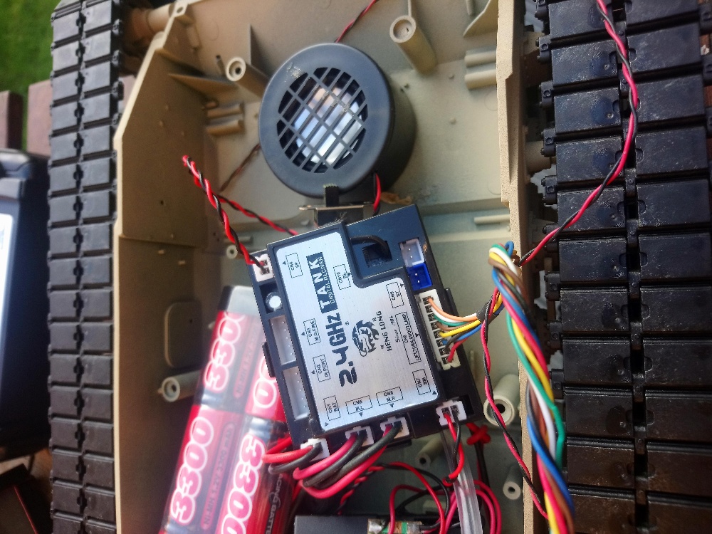

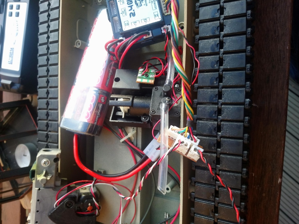

I've used a new heng long two sound white label front unit. All is good except there's no main gun fire. When I press the button nothing happens. No sound, no recoil, zip. Having said that I'm using a mix of old and new wireless harnesses and currently nothings going into cn3 (mg fire five pin port) or cn2 and the blue cn9.

Two questions, were the original electronics the older version? If yes, have you changed the 8 pin hull connector board to match the duel sound MFU, because they are wired differently?
Another sort of question, I'm guessing you have all the turret electronics connected out of sight in your pictures, as some features don't work without it all connected.

Hiya.
No I've been using the old 8 pin connector so I understand I need a new one of those.
Also it's been pointed out where to plug the fire two pin lead into the five pin socket.
I'm hoping once I get the correct board connector all will settle down.

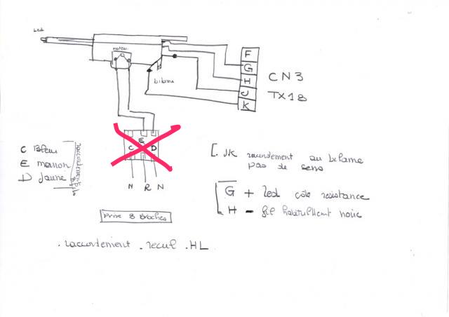

RX 18 2.4 Ghz diagrame wires ...
Jofaur86
Posts: 2172
Location: Centre France
Re: Continuing ztz woes
Post by Jofaur86 »
Diagram wiring principe shooting ball,in 2.4 Ghz the small platinum ( X red ) is pics pades ni longer exists .....

All sorted thanks lads. New Hull socket and flash unit sorted it.
