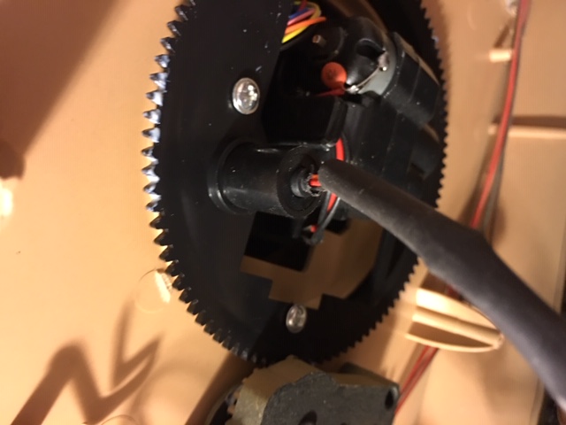

Hope someone can identify this plug in the turret rotation gear for me,can it be unplugged or does it need to remaining the gear this is the metal Taigen Tiger 1 Mid with barrel recoil.
Need to know cuz I need to inspect the recoil mechanism.

I assume you have a 360 degree Turret ring instead of the old 320 degree turret ring in which case that "Plug" is carrying all the cables from the Turret through the turret ring to the Daughter Board and it turns independently of the Turret ring thereby ensuring the cables don't get pulled out of the turret as it turns all the way around.
I would unplug it at the Daughter board.
Re: Have a turret conundrum !
It should also just pull out from the turret ring (don’t pull from the wires or try and open it though!).

Yes, it just slides out sideways from its circular slot in the ring, and it isn't meant to come apart.jimbo_wa wrote:It should also just pull out from the turret ring (don’t pull from the wires or try and open it though!).
