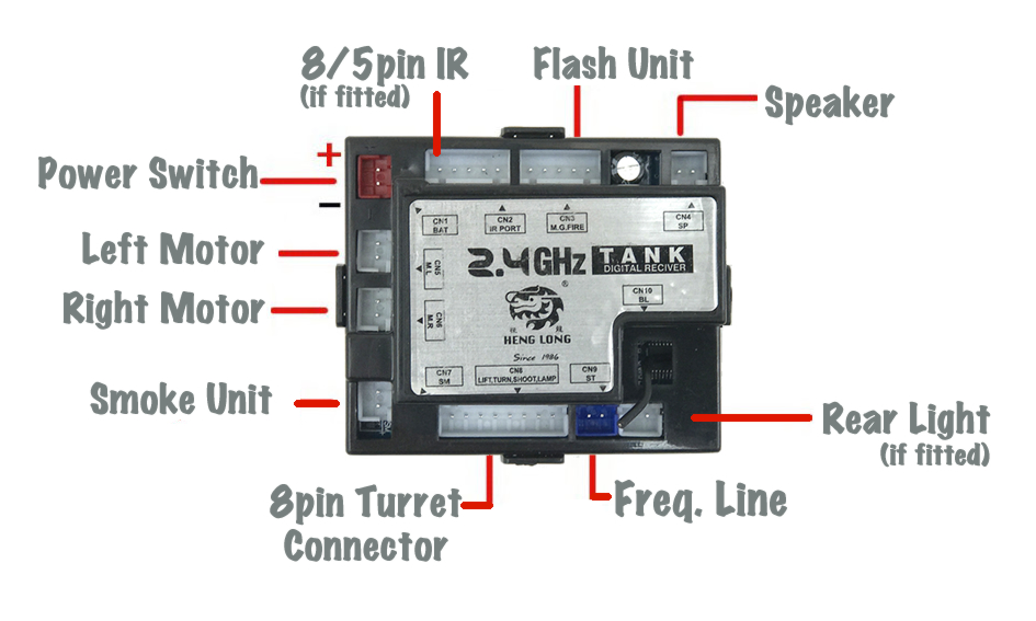

For info,
Switch + cables
https://www.taigentanks.com/taigen-part ... /tag120600
RX 18 schema principe
Switch + cables
