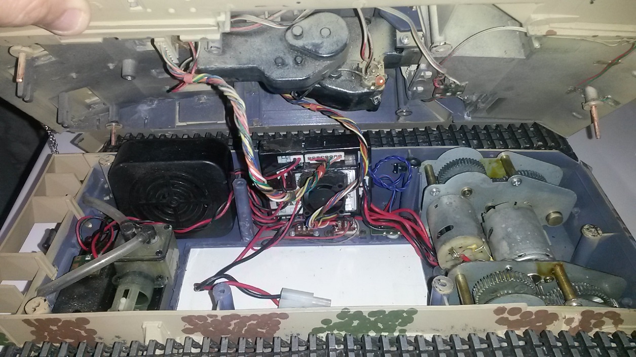

I've modded all of mine with rare earth magnets holding the upper to the hull. All you have to do is pull it apart and rotate the upper 90 degrees and sit it on the hull. Beats turning it on it's side, or even upside down.
Here's the inside of my Stug III. It's laid out the same as my Pz III. When I got it, the battery door was missing, so I replaced it with a piece of sheet plastic. Notice you now have a lot more room in the hull, and can run a standard size pack instead of the smaller one that come with it.
The magnets make it so much easier to change the battery or do maintenance.
ALWAYS remove the batteries from the tank when charging! LiPo's can burn, and burn extremely hot. I've seen NiCad batteries vent when charging as well. They aaren't as hot as the LiPo's, but will still burn a tank up.
