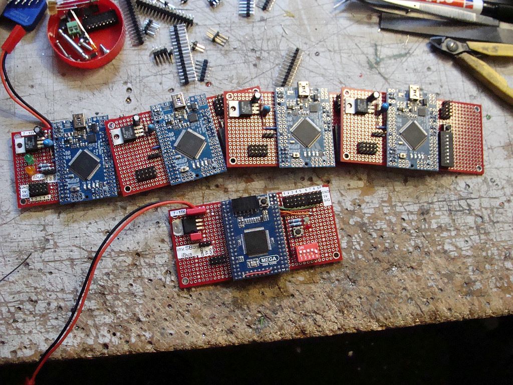

it´s very easy to build a TCB by your self with a Arduino Mega: My TCB´s with a Mega 2560 Mini Pro:

Hi, it might be easy for you. For us, mere mortals, seems complicated, lol.jhamm wrote:Hi,
Have you planned to sell your TCBs? Is it possible to make them smaller?

No.Rad_Schuhart wrote: Have you planned to sell your TCBs?
This is certainly possible with a baseboard and piggyback the mega mini pro.Rad_Schuhart wrote: Is it possible to make them smaller?
But i am not an electronics engineer and not familiar with circuit routing program.

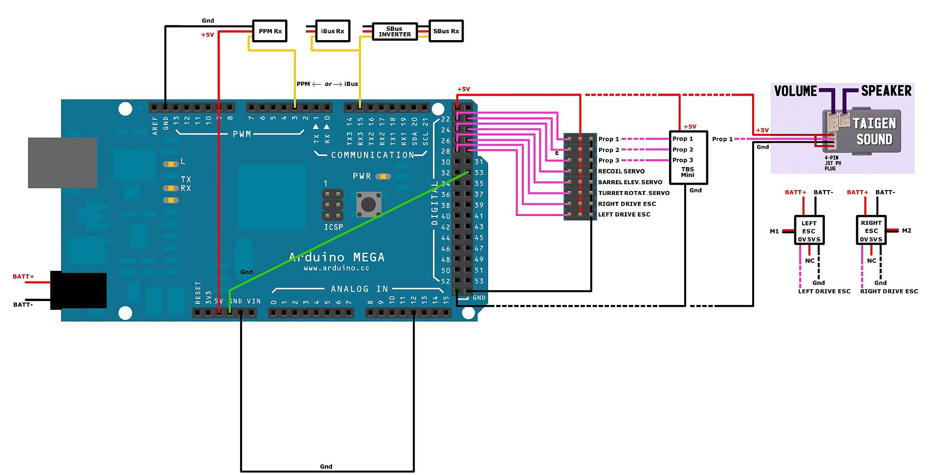

Could you explain what is in the photograph? The red boards all have different components on them?
The components shown on the red boards are not shown in the circuit diagram? Eg Resistors etc.

For you is the picture with Arduino Mega....
Do this as first try - you need only some wire
If this work, we talk about the Mega 2560 Mini Pro.

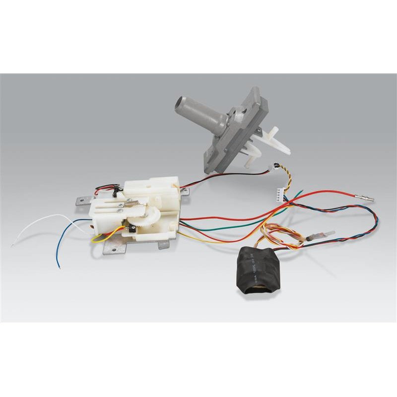

Many thanks, that makes sense. I just need a PWM>PPM converter, cheap to buy, and two speed controllers. I have a Benedini Mini clone on the way for sound.
The only complication is that the Torro Tiger I am going to use to test it has a non-servo recoil/elevation. I will need to figure out how to get that working.
- torro-recoil-unit-for-tiger-1.jpg (38.59 KiB) Viewed 1667 times

It is easy...wibblywobbly wrote: The only complication is that the Torro Tiger I am going to use to test it has a non-servo recoil/elevation. I will need to figure out how to get that working.
Look at here:
http://openpanzer.org/forum/index.php?topic=16.0
There is all nessecary information
