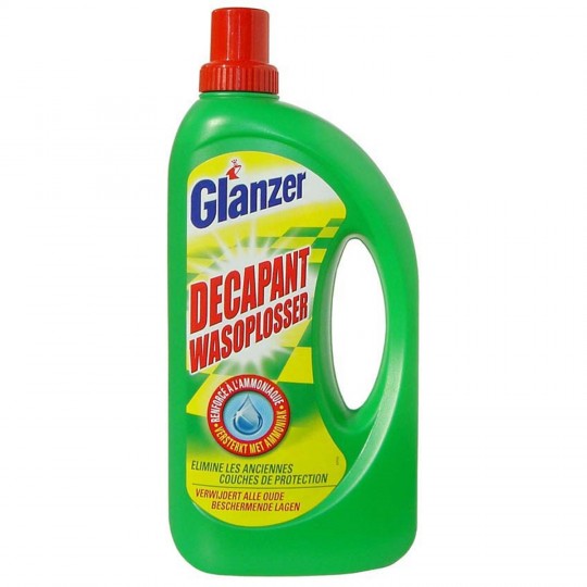

Hello :D
Personal use,break fluid,but a little greasy or so this ( picture ) wich is top,because for me decape
Oven since deleted some toxics products in the formula ?is not as effective for Use Européens ??for the " Glanzer ",small pieces to soak,large pieces wiith brush :thumbup:
Apply same os abowe,rinse with wather and détergent ;)
Price Hyper market 3/6 €
