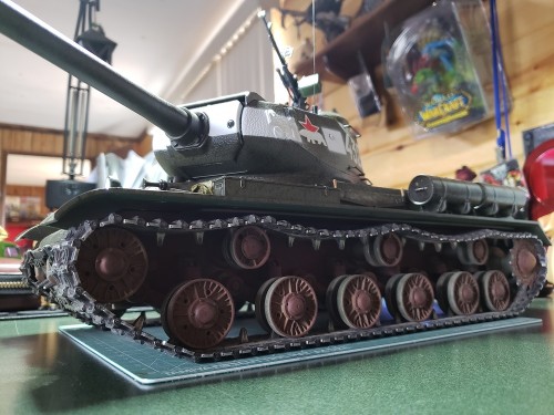

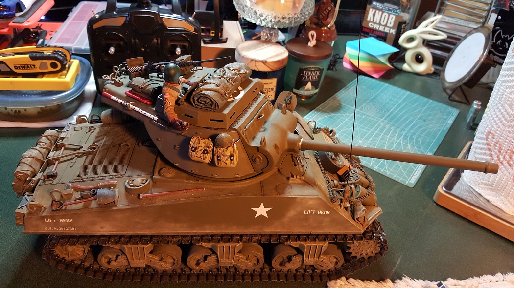

Welcome to the Forum. You have two posts so I'll bet the other one is an introduction. Taigen\Torro tanks are some of the best offerings currently available in 1/16 scale. They may not be 'all metal' like the newer MATO offerings but that is part of their design and make the turrets infinitely easier to work on. This feature combined with their excellent metal lowers on their 'Pro' series make them a great RTR tank. They are only getting better. MATO tanks are a little more expensive than Taigen\Torro and they _do_ have the recoil\ir barrel flash functions like Taigen\Torro tanks. Just make sure you specify and buy the type with those offerings available. Their metal lowers and turrets are solid. The only severe issue that I have run into with them is the pot metal that they use for hooks, handles, guards, etc. is sometimes crumbly and needs replacing with parts from a Tamiya sprue or some accessory Schumo nickel steel parts. Either manufacturer will serve you well and both offer a wide range of RTR Tanks. I will include a pic of a Mato M36 B1 and the latest Taigen\Torro IS-2 tank.
Taigen Torro IS-2
Taigen Torro IS-2
MATO M36 B1
MATO M36 B1

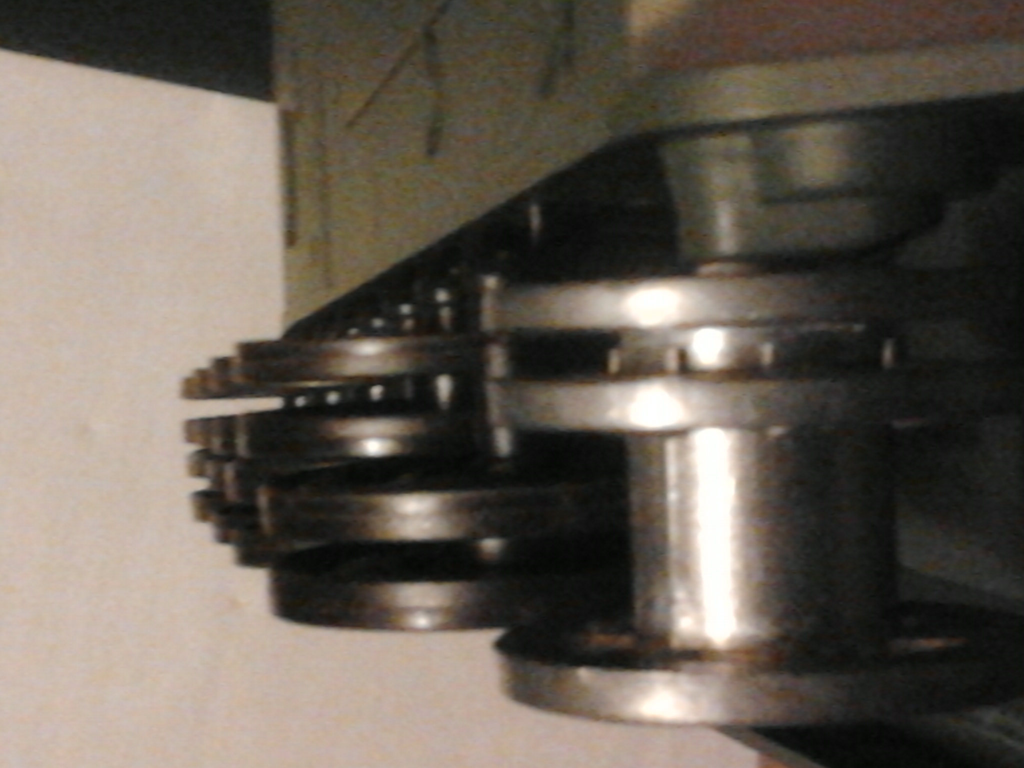

I have three Heng Long King Tigers with plastic suspension arms. Sadly they suffer from those arms being held in opposing directions, which causes track derailing problems, especially as both my Porche versions have idler misalignment.
I believe the taigen chassis would be an advantage, unless you fit track tensioners and metal arms to a Heng Long.
2015-01-13 01.16.29.jpg (625.81 KiB) Viewed 1216 times
