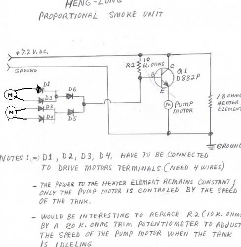

Hello,
No Tamiya modules,are not intended for a fumigène :thumbdown: it is certainly possible to install it ?
Attached here is a published diagram of this forum it seems to me ?

Yes,found,but in fact no connect directly to Tamiya,but on motors and batteries via spécific switch? But at least am aware that exists,tank you fir the information

Jofaur86 wrote:Yes,found,but in fact no connect directly to Tamiya,but on motors and batteries via spécific switch? But at least am aware that exists,tank you fir the information
At the bottom of the page:
Connection of wires for proportional units
Instructions (based on Heng Long installation)
1) Plug the 2 pin plug into the MFU smoke output port
2) First pair of red/black cables connects to one motor (red to red, black to black)
3) Second pair of red/black cables connects to other motor (red to red, black to black)
For tank electronics without switched smoker output (Tamiya). Step 1 above, need to remove the 2 pin plug and connect to the battery supply via a switch (not included)
