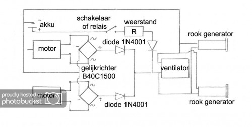

Hi all just started to convert a Tamiya king tiger into a Jagdtiger using a Tamiya king tiger hull and torro upper hull. I was wondering if it is possible to fit a smoke unit to Tamiya electronics and if so what one should I get

No Tamiya modules,are not intended for a fumigène :thumbdown: it is certainly possible to install it ?
Attached here is a published diagram of this forum it seems to me ?

www.rctankelectronics.com
The Tarr Mk 3 and 4 Pro fully proportional smokers work with Heng Long, Taigen, Torro and TAMIYA !
On the Tarr smoker page is all the wiring information including a diagram to connect the smoker to a TAMIYA Tank. :thumbup:

http://www.rctankelectronics.com/store/ ... e_unit.htm
Now you are at the correct page I suggest you read the whole pages contents and where directed CLICK on the highlighted words. :thumbup:

Yes,found,but in fact no connect directly to Tamiya,but on motors and batteries via spécific switch? But at least am aware that exists,tank you fir the information

Jofaur86 wrote:Yes,found,but in fact no connect directly to Tamiya,but on motors and batteries via spécific switch? But at least am aware that exists,tank you fir the information
At the bottom of the page:
Connection of wires for proportional units
Instructions (based on Heng Long installation)
1) Plug the 2 pin plug into the MFU smoke output port
2) First pair of red/black cables connects to one motor (red to red, black to black)
3) Second pair of red/black cables connects to other motor (red to red, black to black)
For tank electronics without switched smoker output (Tamiya). Step 1 above, need to remove the 2 pin plug and connect to the battery supply via a switch (not included)

I have to update my smoke generators entry.
Here I wrote why I would not get one of those Tarr smoke generators.
https://radindustries.wordpress.com/201 ... erators-2/
And what do I want to update in that entry?
The smoke fluid. I found a mixture of glycerine and destilled water works very good too, without any nasty and toxic smell.
The smoke machines I did with my friend Daryl Turner.
And also the concern here, how to fit it when using Tamiya electronics or any other electronics in the world.
What I did back in the day when I used Tamiya electronics is to wire a cheap 1 euro free shipping ESC. It is feeded from the battery, and is trotthle responsive, so the faster the tank drives, the more the smoke you have. Of course it requires a the use of a radio with more than 4 channels, and a little bit of radio programming, so you can have some smoke when the tank is starting and/or iddling too. And also you can switch it on and off from the radio, so you wont overheat it, which is very important.
