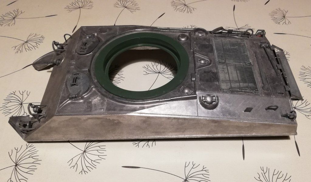

Everything is possible ;) I've made simillar different modification - Taigen turret on Mato metal hull. To fit I cut out ring from Taigen plastic hull and use it in in Mato hull.

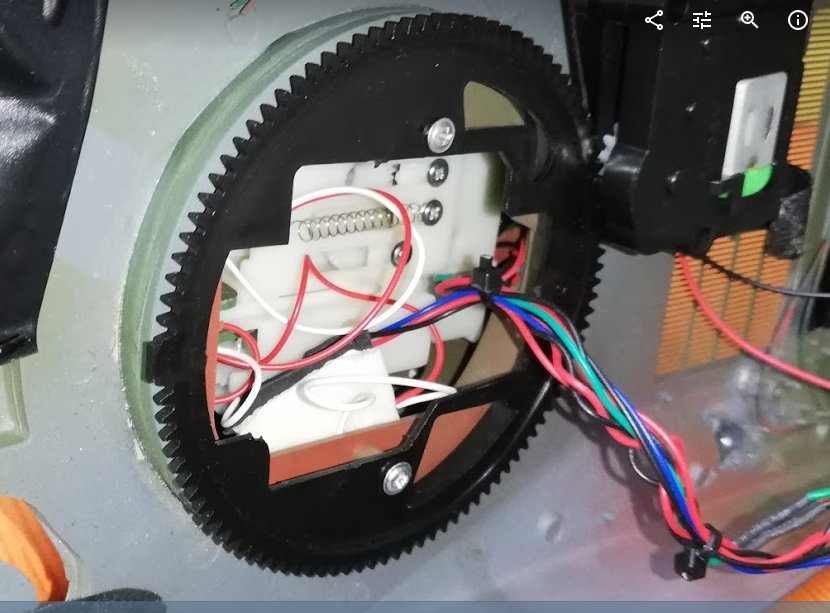

Do you have a picture of the inside of the upper hull?

I only make bigger hole using dremel and side grider.
