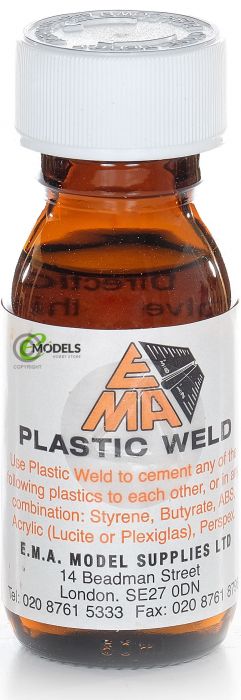

E.M.A. 'Plastic Weld' works on styrene and ABS but, like Tamiya ABS cement, it really does eat into the surface of the plastic. For this reason, you have to wipe up any spills immediately, and not apply it excessively.
https://www.emodels.co.uk/ema-57ml-plas ... -ppc2.html I have used this when other types of cement fail to get the bond I need. A whiff of this stuff can really make your head spin, so use it in a well-ventilated space. :crazy: Out of doors is a good place. :D
EMA Plastic Weld
EMA Plastic Weld
Plastic Weld.jpg (35.35 KiB) Viewed 1824 times
