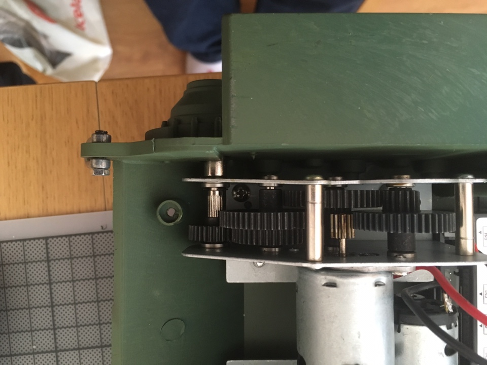

Hi all. Fitting upgraded motors to my HL KT.
I noticed that when I was putting them in, there is about 1mm left/right play in the main drive shaft.
On closer inspection there is a slight kink in the motor wall that opens the gap allowing this to happen.
Firstly, how easy is it to strip the motor and casing to straighten and secondly, is it okay as is? I suspect that the second question is dependent upon wear and tear issues and what to expect given the 1mm play.
Also, whomever built my HL KT has also snipped the receiver wire!!!
I’ve attached photos. When I work out how to attach videos (host elsewhere and link?) I’ll let you see the play properly.
Thanks in advance

Stripping is easy. Just a bunch of screws to undo then it all comes apart. Watch out for the location of parts. Some play can be there due to poor meshing of cogs. Mine does have axial play.

Play in motor shaft...
You don't say play in motor bearings so l guess that's not the issue. I assume then that the play is in the shafts ability to be pushed back and forth into or through the can. All motors will have a small amount of play - the cheaper the motor the more play. Fitting shims costs time and money.
However, when the motor receives power the armature becomes a spinning magnet which pulls and pushes itself to and away from the two permanent magents inside the can walls. As it does so the armature adjusts its position in the can to optimise its position with the permanent magnets field. This is the position the the motor shaft should be.
A small amount of play allows the armature to find this position so is okay if you are running straight cut gears and not bevels (which try to push apart).
HL brushed cans are not intended to be taken apart but simply replaced when they show signs of wear. At the very low price they cost l would suggest thats what you do if you are still not happy.

Sorry, I should have been clearer.
The play is in the first cog wheel connected to the arm that the sprocket attaches to. The walls of the right drive unit open slightly further than the left drive.

Wardog wrote:If its the gear box case? Mine arrived bent at the top, just on the contact point.Did not fit into the tank.it was the point of leave,bend back or send back.
So I bent it back.But I did contact seller
T’was an eBay purchase. Bending appears to be the best option
