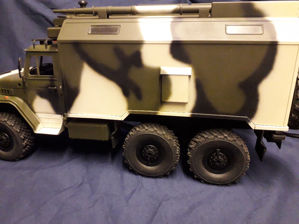

Couple of pics of my Ural.

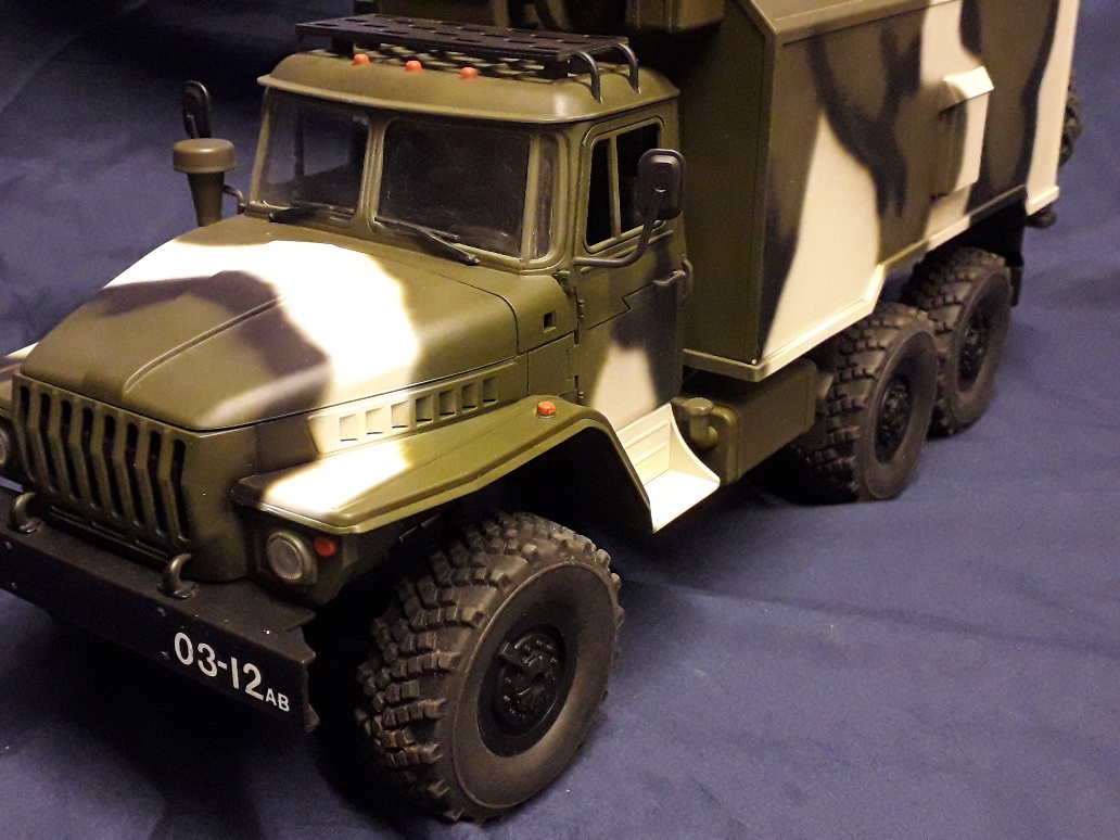

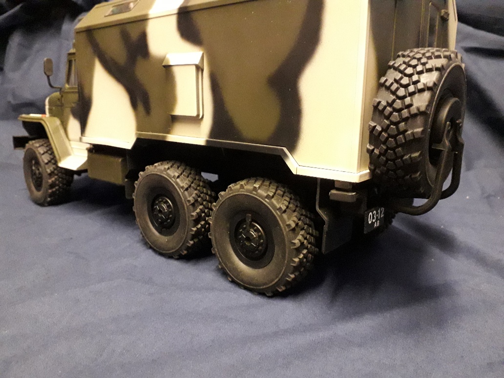

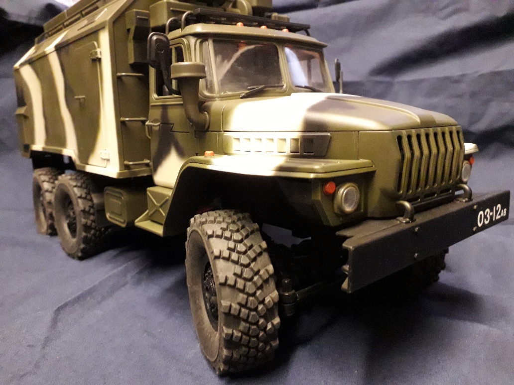

A few pics of my modified Ural, 2 speed gearbox 380 motor, metal driveshafts and metal axle internals, runs proportional truck engine start run stop sound, working head and rear lights.
Airbrushed with Tamiya acrylics in summer woodland cammo pattern, all by me.
Hope you like it.
Regards.
Sub.

Nice lorry mate. Are you able to shed some light on the electronics you used please?
I have a need for a set soon

Hi Mr Bix.
It has a Spektrum 6 ch radio an Mtroniks 10amp micro speed controller, 2 way switcher for lights and sound plus a German GEWU truck sound unit, a servo operated 2 speed gearbox and 380 motor obtained from e bay.
Hope that helps.
