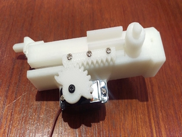

Everything works nirmally without the barrel,is the clark system setting OK ?the servo gear with the rack ? Setting the servo neutral ? Your radio is not programmable,it is not pissible to ajust the servo travel ( travel % ) in %.
This is the system ?
Re: Clark recoil servo issue
Ensure that the recoil slides freely without any resistance, sanding of the mechanical part is always required for smooth operation. My guess is that there is too much friction in the slide mechanism, giving the micro servo a hard time pulling the slide with the added weight of the barrel. Also ensure the servo is solidly in place. Try replacing fragile servo if needed because some gears inside might have been damaged by excessive resistance. Issue unlikely to be due to electronics.

Is this pinion on the servo does not turn in the void ? When force end races? and actually see if slides well? Canon level,and mechanism ?? To adjuste :thumbup:
